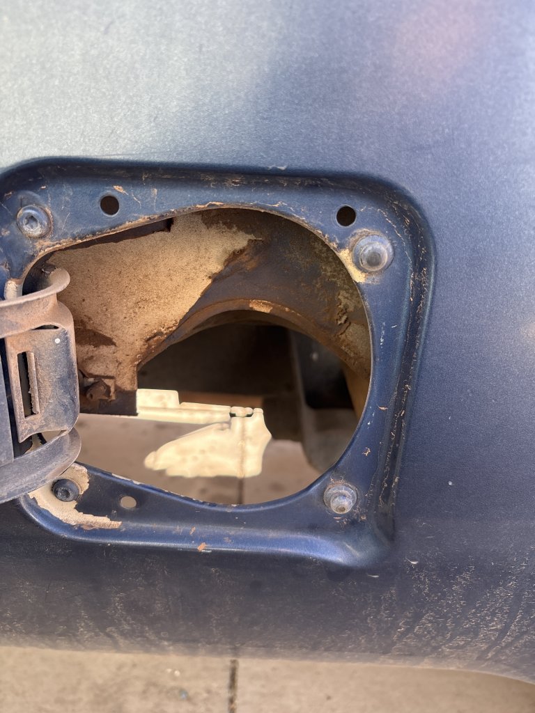

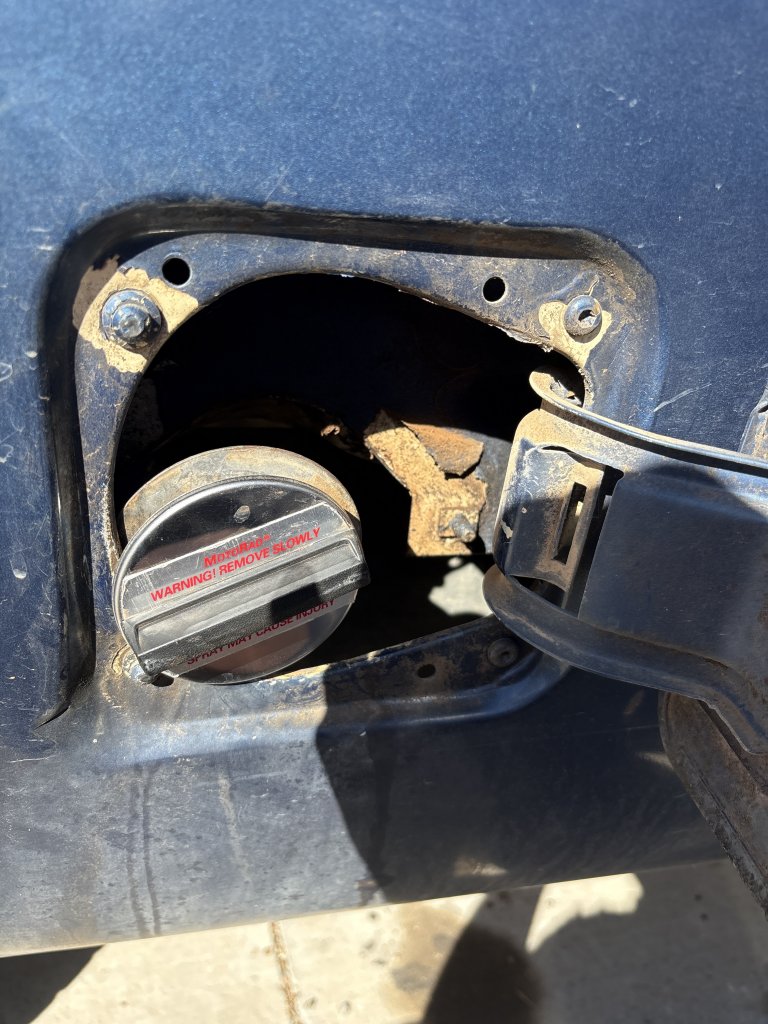

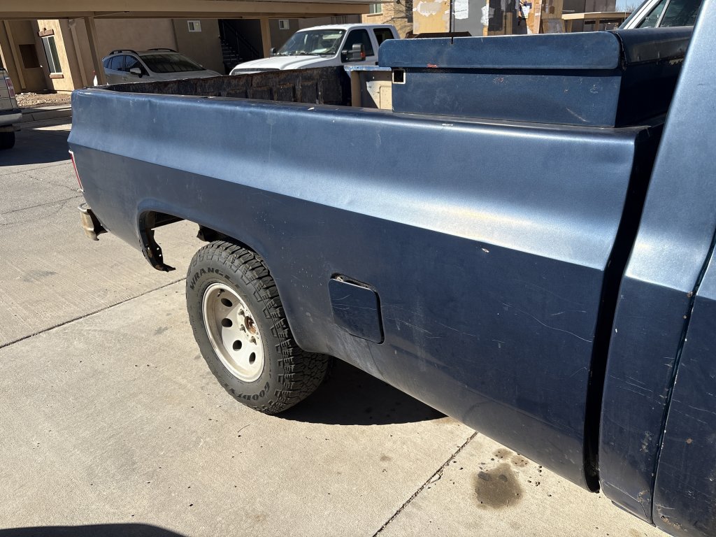

I’m trying to add another gas’s tank on the passenger side the truck is supposed to be a 1973 but I think the bed is newer if anyone can let me know so I buy the right filled neck.

That's definitely a '79-up bed because '79 was the first year for gas doors instead of exposed fuel caps. I believe with that filler neck shroud, that would be a '79-84? '85-up they changed to a plastic surround that encapsulates the whole filler neck rather than just holding the top of it.

The plastic shroud started in '84. Unless my 84's original bed wasn't actually original. But I'm 99.9% positive that it was.
The bed in the pictures looks like a plastic shroud type bed, but without the plastic shrouds to me.

I couldn't remember where the break was, you're prob right
You are 100% correct, and yes, the plastic filler neck "shroud" is missing here.
So you need the 3-screw metal style, 1984-87 model, fuel filler to hose now too.

Gas doors are 78~79+.
I’m not sure what year the tailgate logo changed from centered to the right side but I believe it was around 81.
I don’t know of any other ways to identify the year of a bed.

Are you the original owner of them? Gas doors didn't come along until '79.

Before 84 would have a metal bracket to mount the filler neck
Your picture just reminded me that there was also a change in the construction of the fuel doors. I don't know what year that happened. Sometime before '84 I believe.

I dont know the exact year, but I’d guess 1984-1985, as the 85 I parted had it, on the front of the bedsides there are some plastic plugs, that are not present on earlier beds.
Anyone with an 81-84 say if your bed has them?
