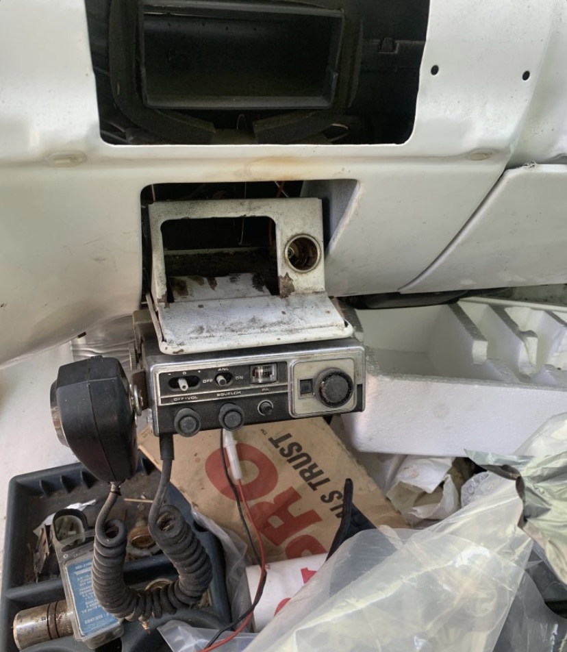

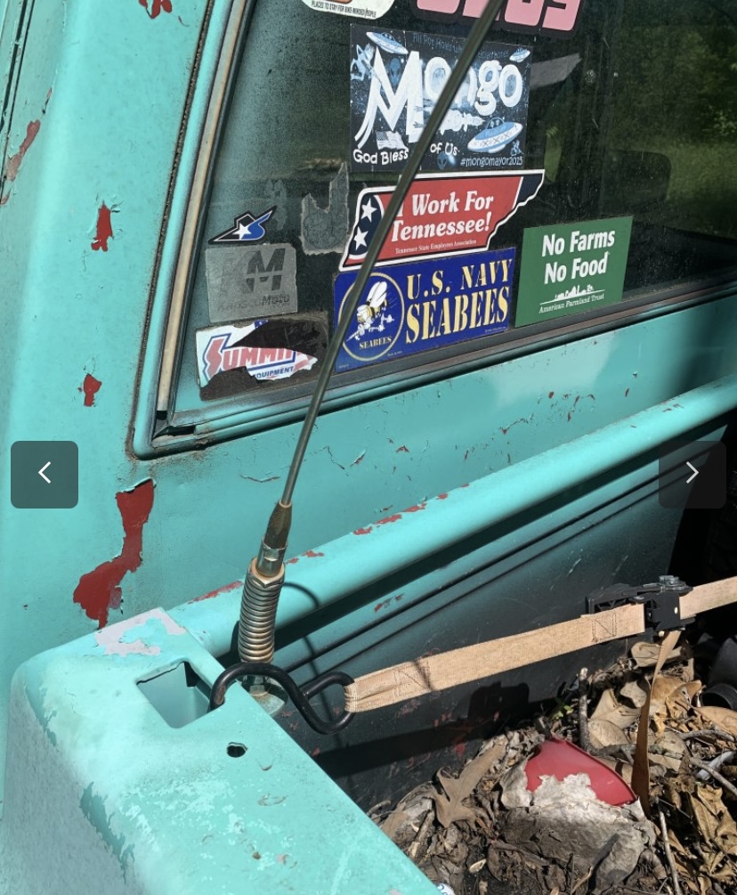

Vintage Sharp 23 channel, dual polarity, mic built in to the case.
102” stainless steel whip, on a spring. Bent back and clipped to the bed rail. Will likely go back to a 3’ or 4’ Firestick.
Actually replacing the barely works factory am/fm radio with an FM only 8-track. Real tuner will be in the glovebox. :)
