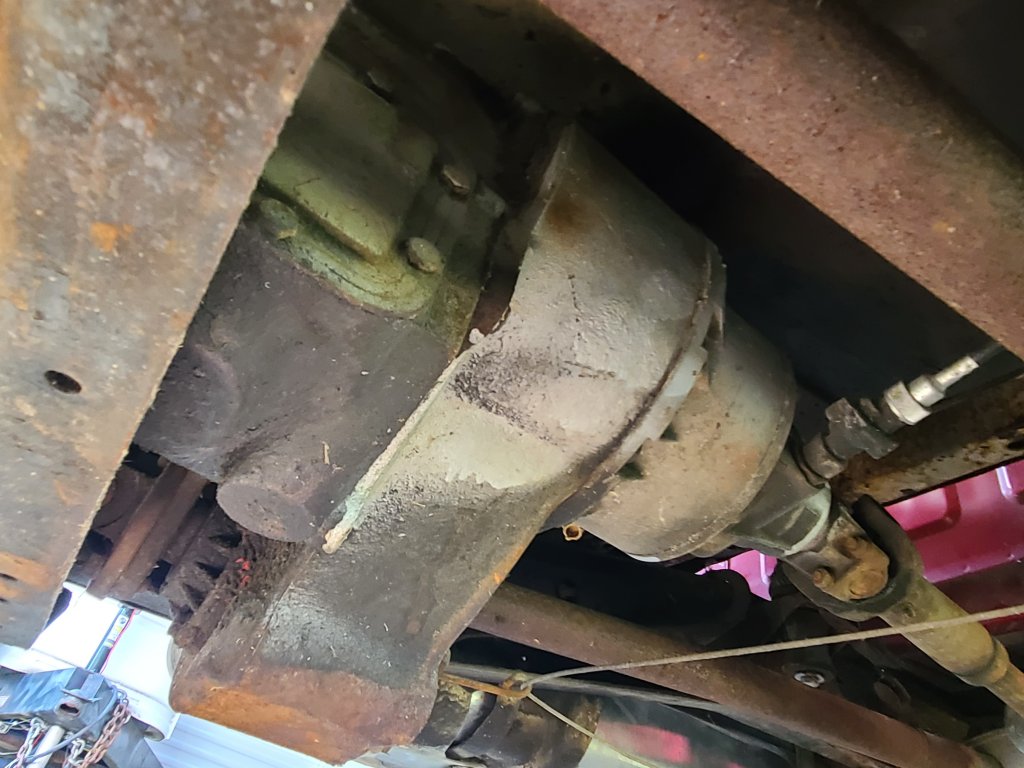

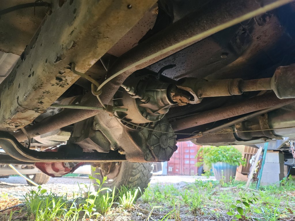

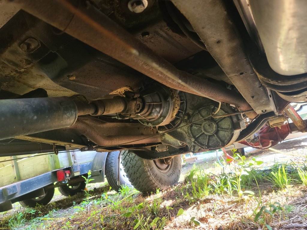

Maybe some one can help determine what transfercase this is in our truck
Vbb199
B-rate Hillbilly Customs
Jan 12, 2018
9,316
15,950
Salisbury NC
Vince
89, 79
89 Suburban R1500, 79 C10
350, 502
Appears to be a np205 :)

Agreed, it’s definitely a 203.
A 4500 will have a 32 spline tailshaft so your 203 will need to be from a th400 for the input spline count to be correct. (th350/203 is 27, the rare 4spd/203 combo is 10).

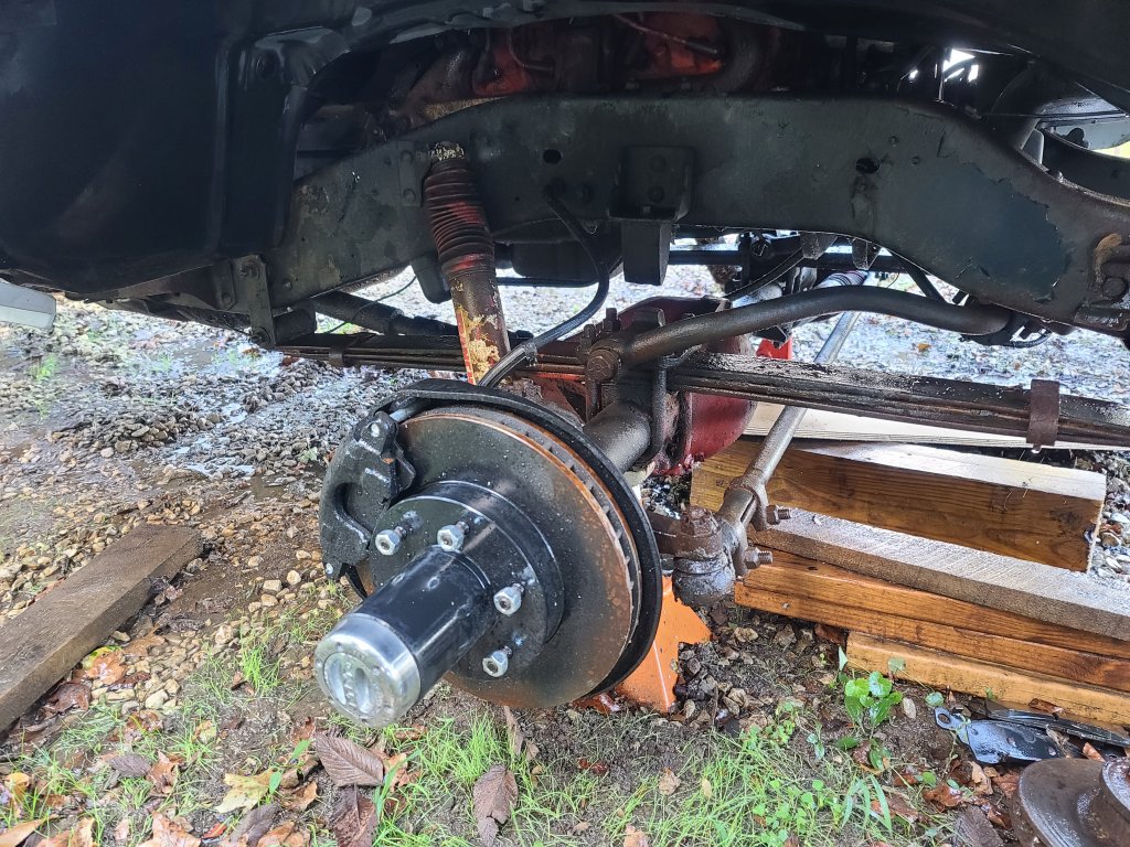

Like these ?
Bextreme04
May 13, 2019
4,546
5,842
350-4bbl
There are several different types of NP205 with various input splines, types, and bolt patterns. A figure 8 NP205 needs about a $600 adapter kit to bolt up properly. The kit linked below is specific for 10 spline input, but there are multiple kits for the various input types on the figure 8 units. https://www.polyperformance.com/adv...FID8klWgd9lSysJtSbCyTEIJ7UfR_1HxoCj94QAvD_BwE
The other option would be a round pattern NP205 from an 85-up 1 ton truck. There are a few of those as well, and it looks like you would need about $150 in parts and some machine work to get them to fit. Here's a thread on Pirate 4x4 talking about those two options. https://www.pirate4x4.com/threads/gm-nv4500-to-np205-round-pattern-with-32-spline-input.2706862/
