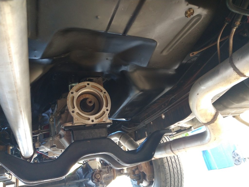

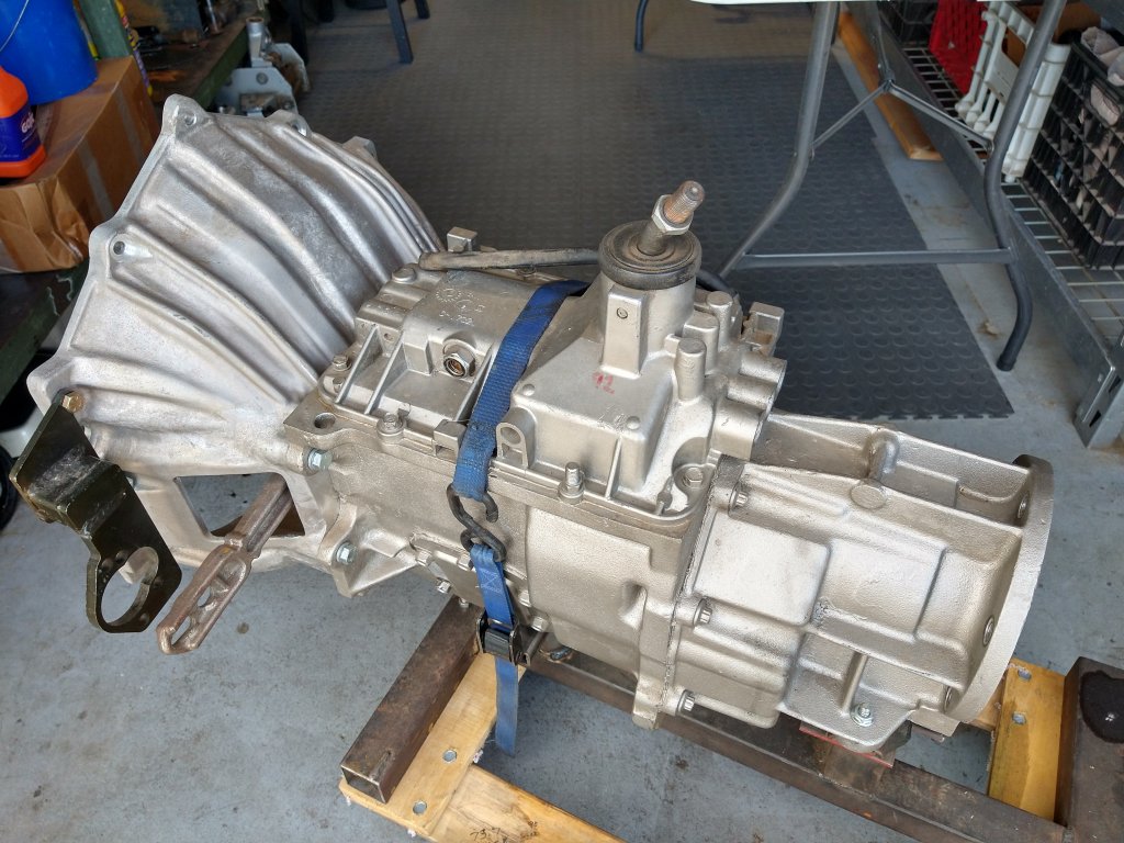

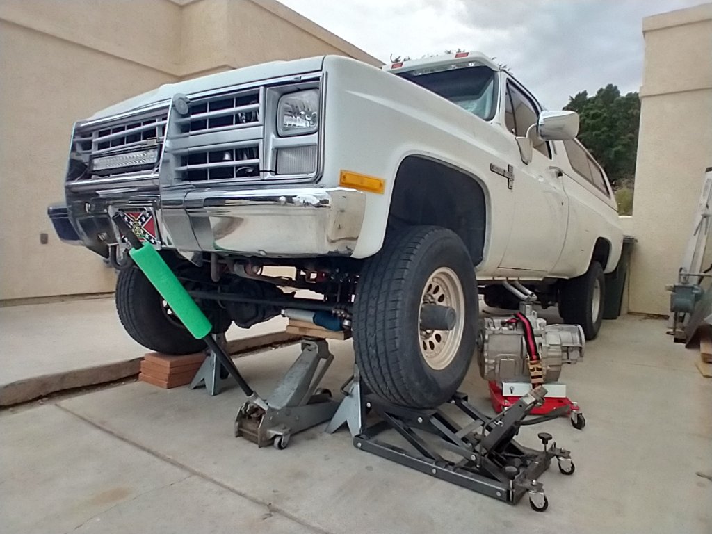

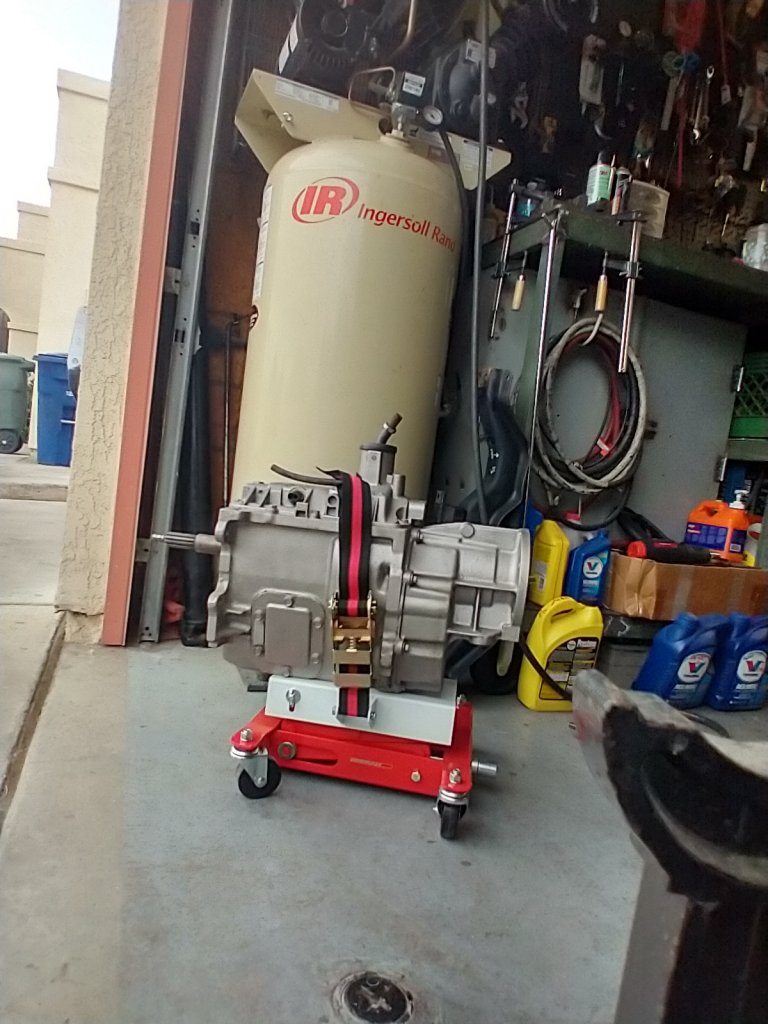

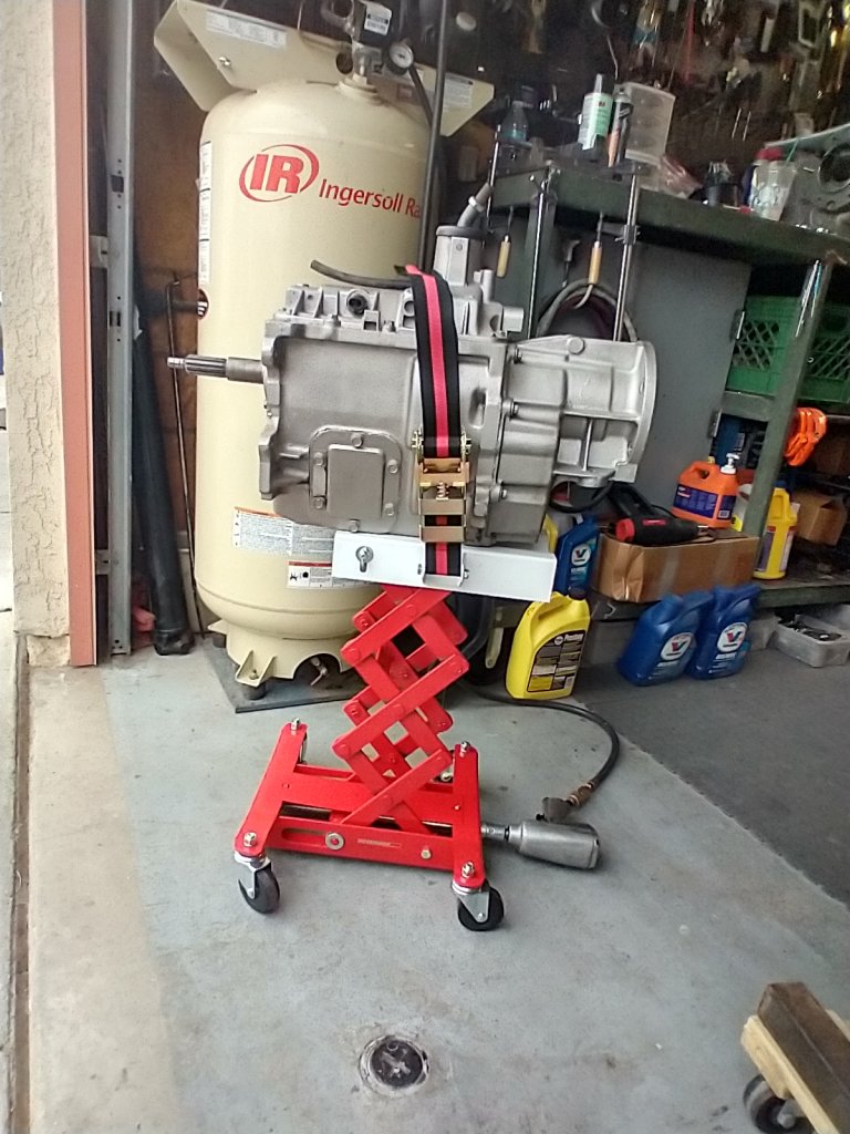

85 and newer 205 DOES bolt to the nv4500. I have done it. You may need a spacer IF the 205 input shaft is the long version commonly found in these t-cases. You can also swap to a short input and eliminate the spacer. Lots of disinformation being tossed around in this thread.

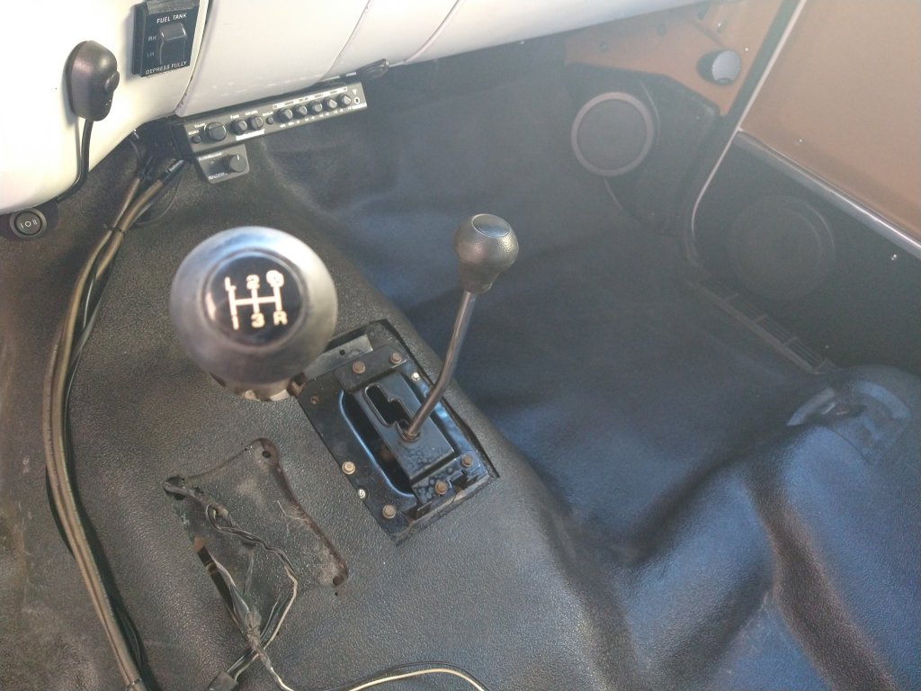

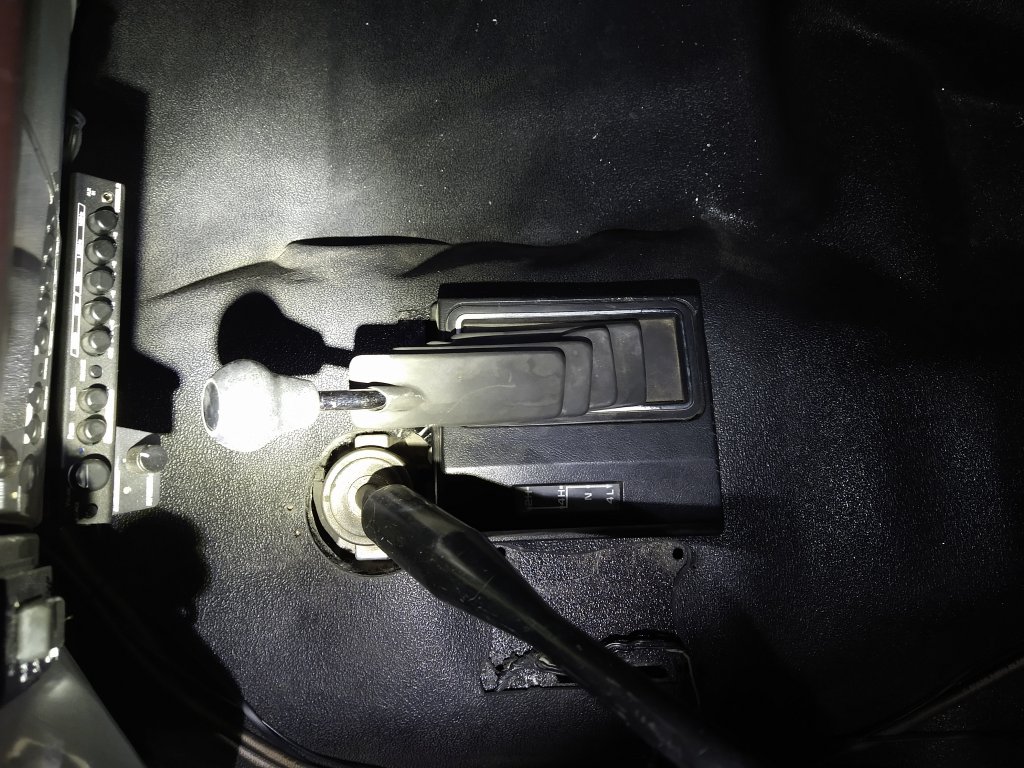

Factory nv4500 located the shifter in the factory location of the factory 4 speed trans. I have done it.

Pics of my 4500 swap for reference.

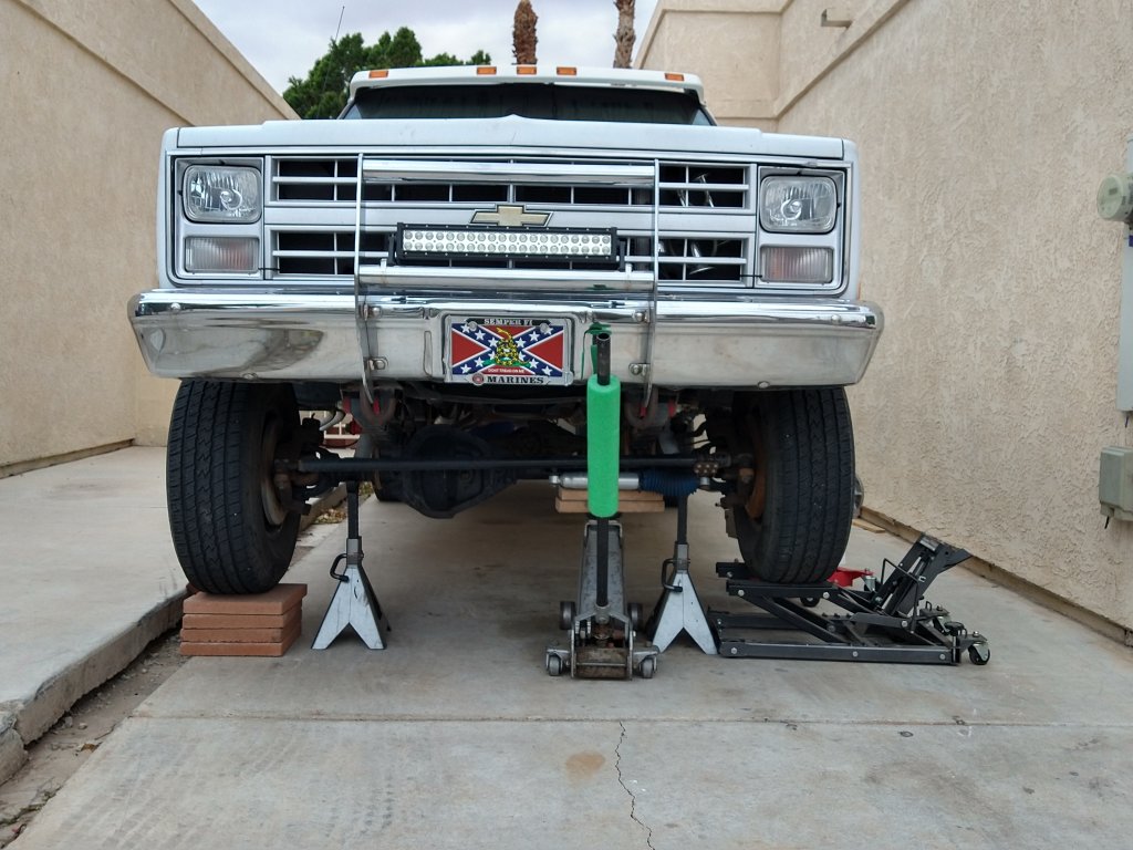

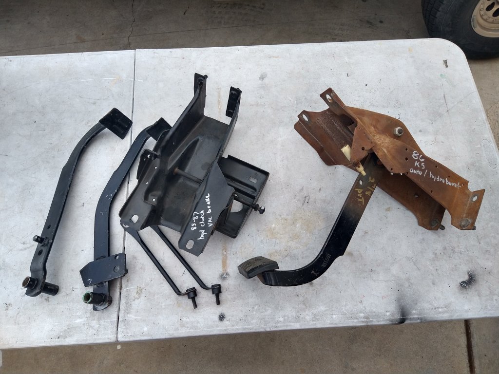

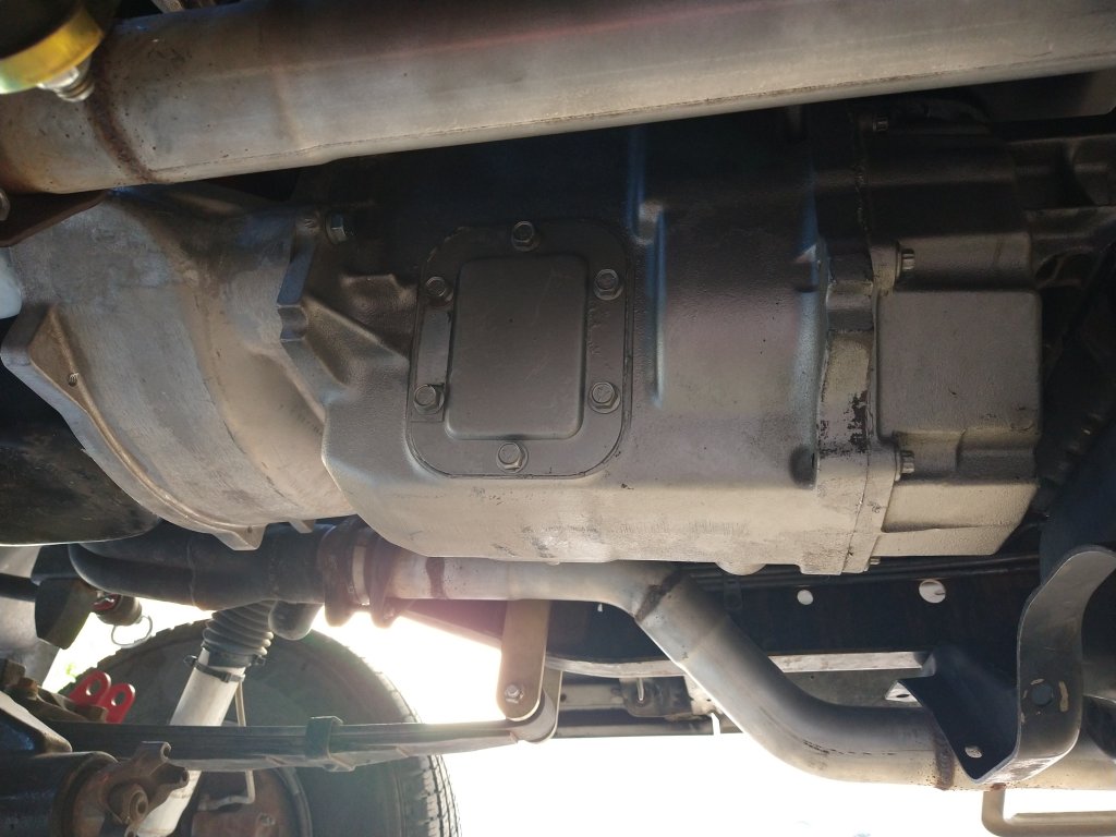

A few more.
I was referring to the T case shifter not the 4500
