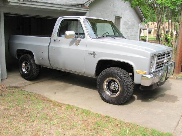

I have 32's on my stock K10. Fits and looks perfect. They say a 33 will fit on a stock K10 but I think it would be a little to much for stock.
