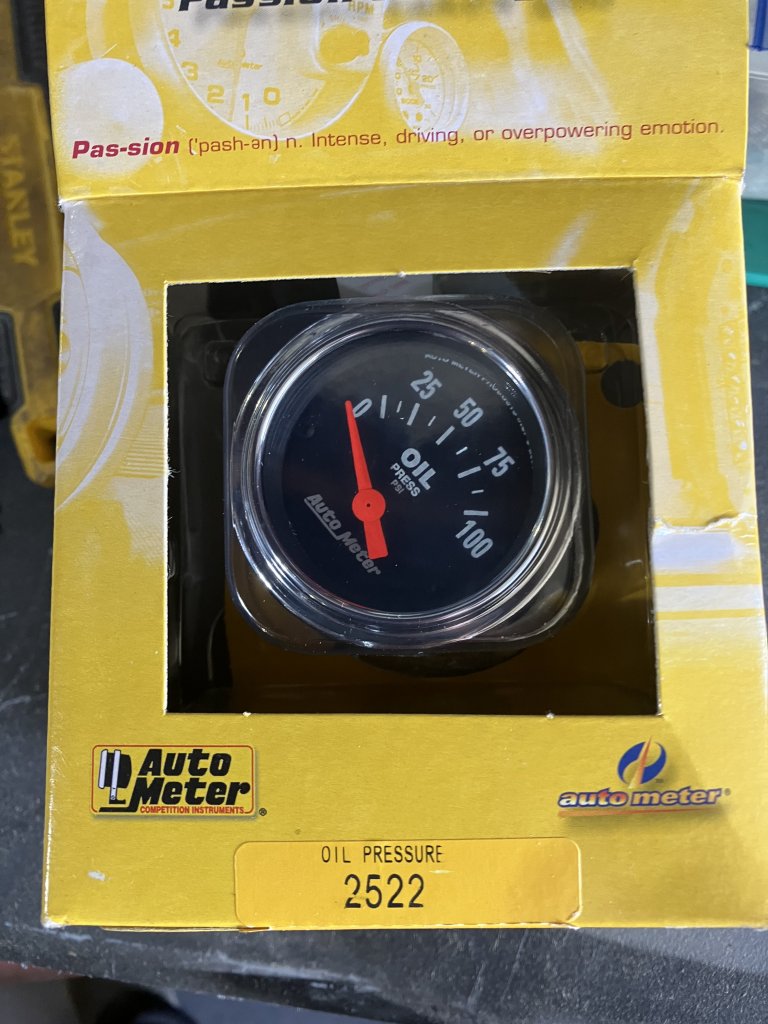

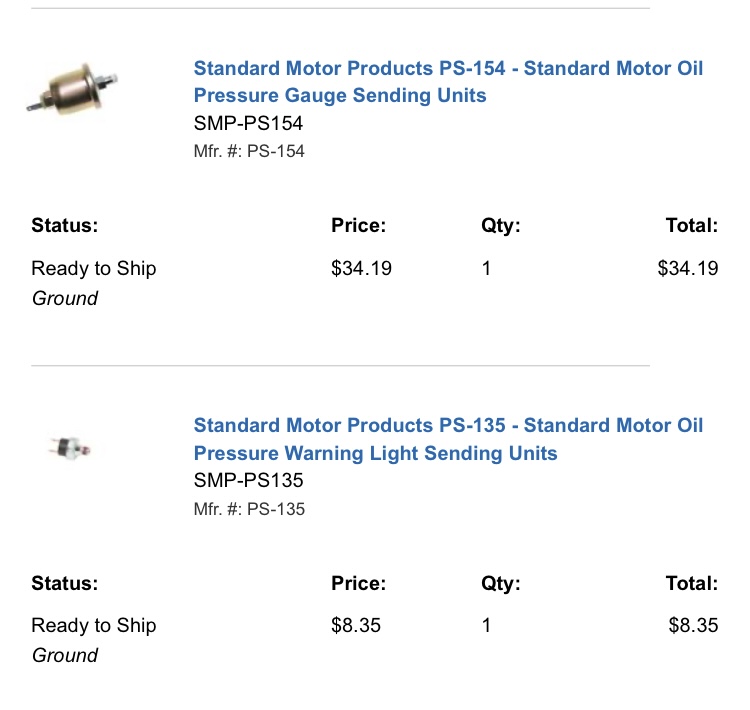

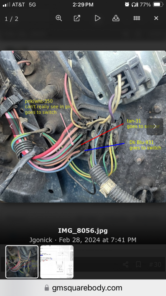

I called Summit Racing to have them confirm the PN’s of the OEM style oil press sender (that mounts close to the distributor) and OEM oil press switch (that mounts at the oil filter adapter) for my new GM crate SBC 350 to work with my factory 0-60 psi gauge. The photo shows the PN’s for my SBC. You will have to get the proper pipe fittings. I have not yet installed these parts to be sure of their proper operation and compatibility with my ‘83 K5. I also bought an Autometer oil press 0-100psi gauge that comes with its own sender so I can monitor the oil press when I’m priming the oil system before I install the engine and I will also mount the Autometer gauge in my K5 as a comparison/backup to my factory gauge after I install the engine. The photo of the wiring was from an older post by someone else. I’m unsure if your wiring or oil press system/gauge is any different than my SBC and K5 that originally came with a SBC305.
