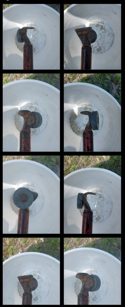

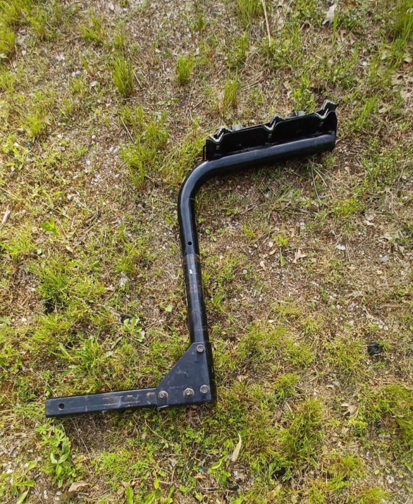

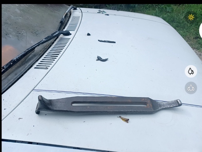

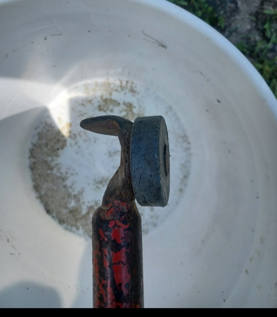

. I bought my Harbor Freight manual changer in 2001, had used Coates Tireman manual machines a lot,and thought how bad can you screw up a manual tire machine. Well,A lot.So I've had to do lots of mods to make my HF machine acceptable.I made a duck head attachment before they were so cheap,it works good,1000 times better than the HF bar. I use a Coates tireman bar most of the time though. Have used a Coates 40 40 bar it works okay also. I drilled holes in my tire mount plate to bolt the wheels down on center instead of using the spider on rims I don't want scratched. Writing this for others that may have one of these and wants to know what works. Coates tireman bar( my favorite) duck head made from hitch mount bike carrier. Guess I should clarify the machine in the picture,somebody threw out,I saw it loaded it up and brought it home for when I want to mount tires.outside. I use the same breaker and bars etc. On the machine in the shop.

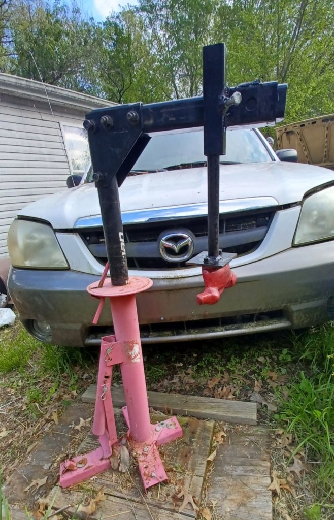

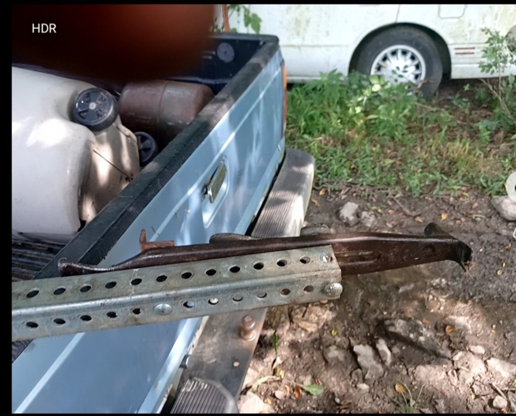

Coates power bar mounted on uni strut works pretty good, when I'm bored some day I'm going to copy the wheelmate/MOJOlever design I think it will work as well as the coates tireman bar. The duck head works very well,just a little more time consuming,take it off put the wheel and tire down,put it back on use it take it off,put another wheel up,repeat. The tireman bar, put your wheel up place your bar,pull,done. Throw on your next wheel. Also had to weld and modify the mounting base,because used the heck out of this 100s if not thousands of tires. I wouldn't buy it again. I'd build it,it would be better and cheaper. Too simple to build just the base and that's the only part of mine that is original,and I had to strengthen it.

I welded the base and secured it to 2x3/4 plywood for 1.5 inch thick,bolted with carriage bolts up from the bottom,makes the base very stable. The plywood bolts to the floor with concrete anchors. I started mounting wheels at 14 including split rims. Bubble balancers and coates manual machines were what every body used including the shops. Last time I worked at a shop with a manual machine and bubble balancer was mid?/late? 80s. Using them now just seems natural,and convienent. It is disappointing that the Chinese came up with their weirdo design that doesn't work for $hit instead of copying old coates stuff. I've got a complete old coates tireman now,but I've got the HF machine modded enough it's not worth it to swap them out,right now( eventually though) I do use the coates bar though.

I use this,but modified it is slicker than snot and breaks down stuff I struggled with before. I'll find my pics again and put them back up basically I just removed the back bar and replaced it with a loop of chain, throw the chain over the tire changer center post position the breaker and pull down on the lever,if it didn't break completely spin it 30 degrees and pull again. I'll look for a pic. the harbor freight breaker is a joke,this thing is fast and actually works,Bought mine at speedway and highly recommend the tool and speedway. Real US based customer service..
