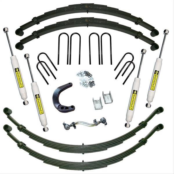

here is a 6 inch for 900 https://www.summitracing.com/parts/rou-20530/make/chevrolet/model/k5-blazer/year/1977 I could be wrong but you may need a body lift as well to clear your tires with only a 6 inch suspension lift no if you had 35s you would be just fine might be able to get a way with 36s but 37s are going to rub
Pretty sure I have a 4" currently, and Im running 37's. On a flat surface, no rub. But on uneven surface, it rubs even with trimming. That link would be good if I was stock, but that kit would only provide 2 more inches for $900.
