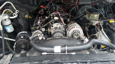

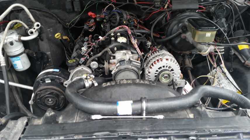

V20
Ac
Stock 1 that was on driver side fits on pass side with the 89 burb mount. Just changed clutches .
Hoses are lil long. But I have ac
74propu
Aug 8, 2015
687
242
florida
austin
1974 1980 1986
c10s/b c10 s/b c10l/b
5.3 / ?/454 tbi
a/c compresser bracket
holly makes a sweet bracket for the 5.3 that mounts it on the pass side and uses the stock compresser and I think ls brackets makes one also
