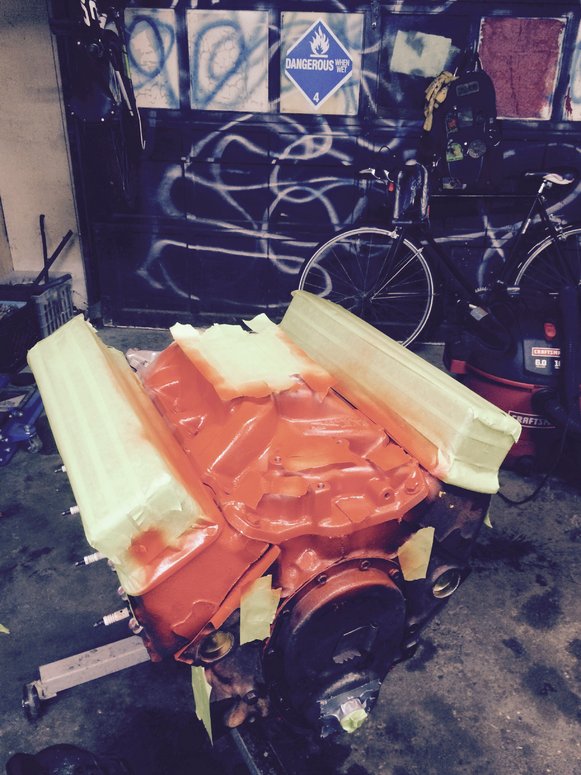

Couple pics from today

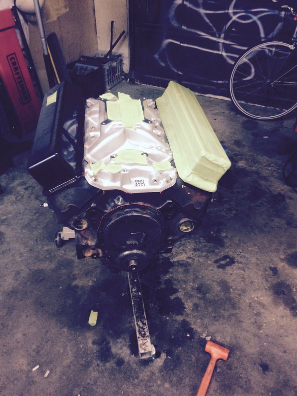

Still having trouble from time to time posting pictures

Nice !!! Old school motor. So did those heads get hardened exhaust valve seats?
Yep! Hardened seats magnafluxed Guide plates upgraded springs 3 angle valve job. I'm just curious how much hp this will make
Should run real good depending on the cam you have. You've got the best Pre Vortec heads you can have. Compression should be real nice.
