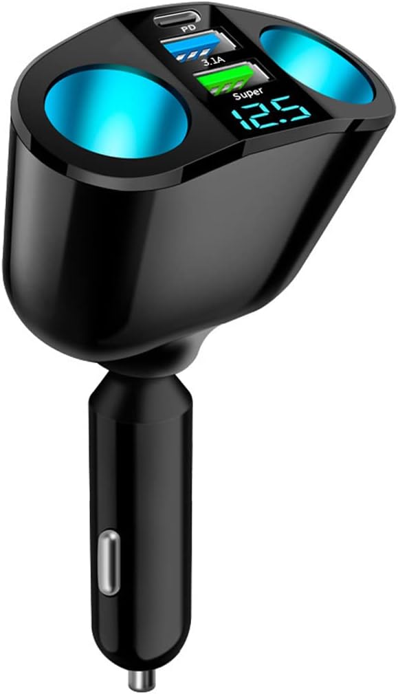

I have a couple of these. They work great.
$7.21
Free same day delivery.
A total of 5 power outlets.
Digital voltage gauge.
