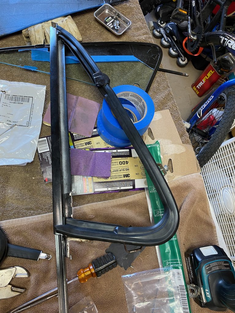

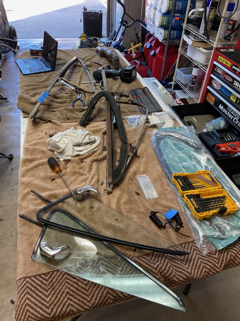

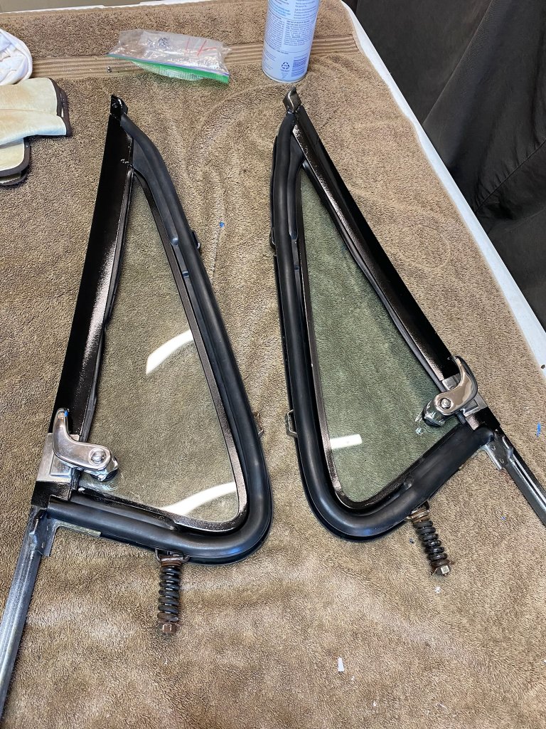

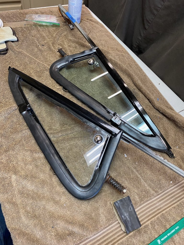

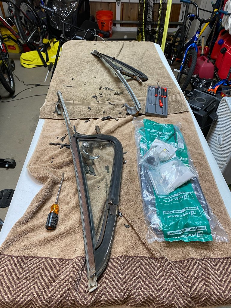

Agree with all above. Precision gaskets and kit. Do NOT take apart frames, its not necessary. We did our last December, you have to have patients and walk away now and then but we did it and we are barley qualified to be on this site!
We took one apart before we realized we did not have too. Ours were 2 piece.
Jeff Gau at Precision is very helpful and will answer questions. Good videos on their website as well
