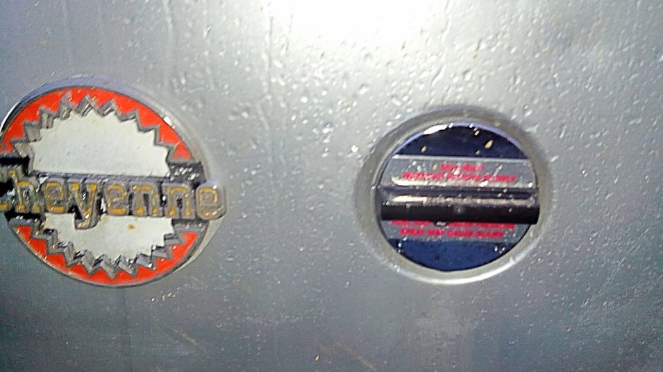

Nobody buys a new gas cap? Really?
There is a lot of science there.
Hey O.P.
Take your gas cap off tomorrow and see if today's problems duplicate tomorrow.
Try it!
And then you'll be all like "Leapin Lizards!"
[yt]zhHjUOQdY3o[/yt]
And then run that happy ass to O'Reilly's and buy a stock replacement STANT brand gas cap for your specific application.
Here's a pic of my new one, it says MOTO-RAD. :party36:
I think it cost $11.00.
40 years later the spring in the cap loses tension and you fail to vent. The pressure builds INSIDE the tank and forces air into the fuel line, resulting in your "half-filled" filter. Remove the cap under that symptom condition and it'll hiss like a goose.
Luckily the solution is both simple and cheap.
