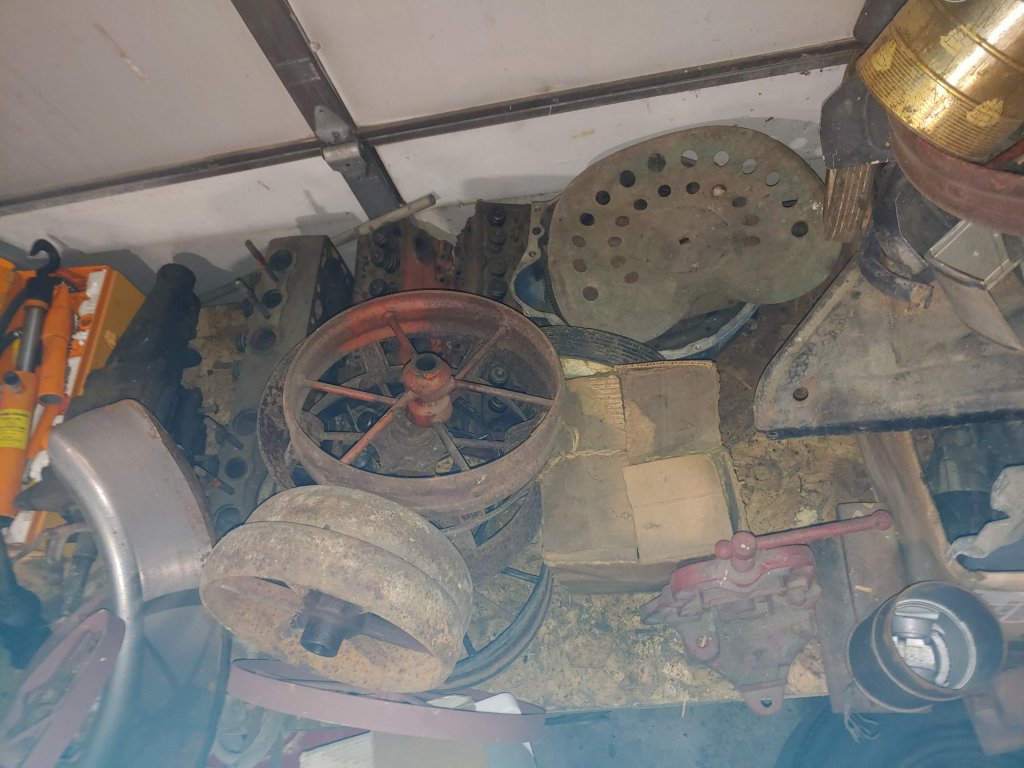

a muncie m20 o:
how do you do that without adapter and what is adapter ring
i have a unit from a chevy monza which i think means m21 but its associated parts should exists somehwere in my shed. i think. it looks like it may have been an auction thing too so hard to say.
Its likely a saginaw, right? since i tried to say I have something maybe lol
