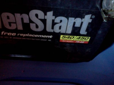

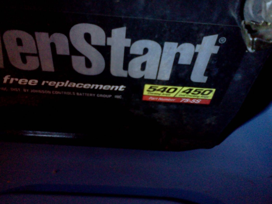

Aha! Think I found the problem. Looks like the battery is not correct for the primary location. I'm guessing the PO took the bigger battery out before I first looked at the 'burb. Nice.
:wtf2: :flame:
It does seem to be taking a charge. We'll see what it looks like in the morning.
-Josh

I had the same problem with my truck. Someone along the way (the PO Bragged about the relatively new battery) threw in the same size battery and I couldn't figure out why I could never get that 454 to turn over. I changed out the alternator and the starter before I discovered that little problem.

And its an everstart. At least 600cca for a burb, more if its full power

Yup. I'm pretty amazed it lasted as long as it did, especially since the carb leaks down and does the "no gas crank" if it's parked for more than a day.
Picked up an O'reilly house brand "Super Start Extreme" at 850 CCA, with a $20 mail in rebate from the coupon section at the counter. It should be a huge improvement. I promised to let the 2 older boys "help" me hook it up tomorrow morning before school.
The smaller battery took a charge, so I'll keep it for now, and put it back over on the secondary side where it belongs.
