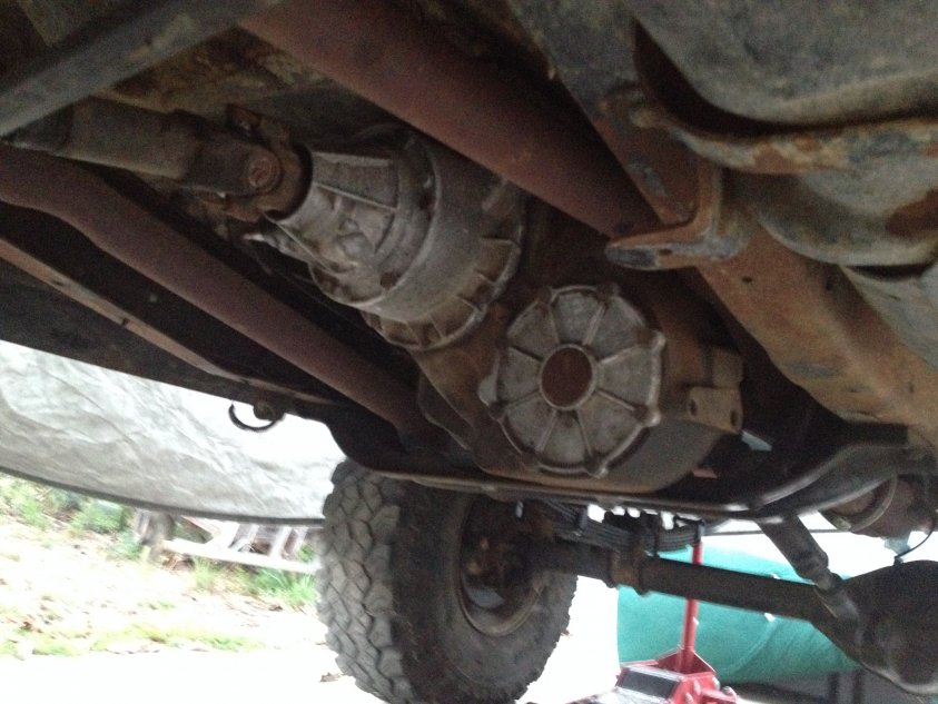

How do I identify my tranny
I'm going thru my SB and trying to identify my tranny and transfer case. here's a pic of my t case to start.

Looking like an NP203 full time case to me.
