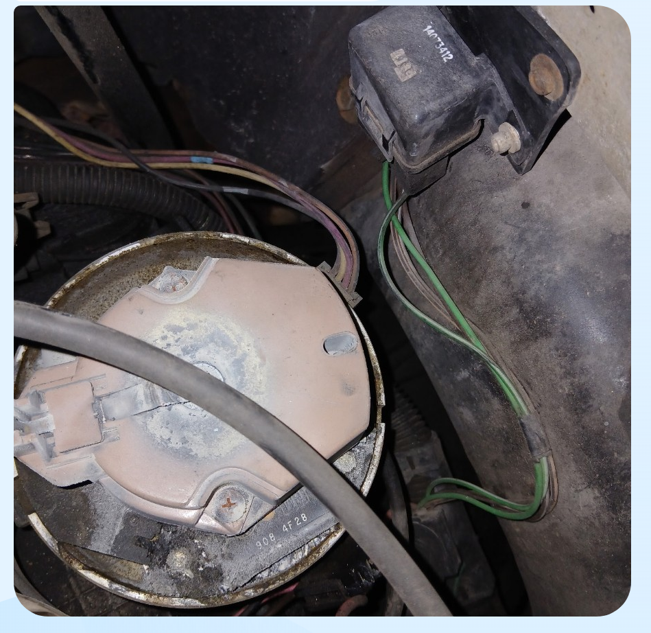

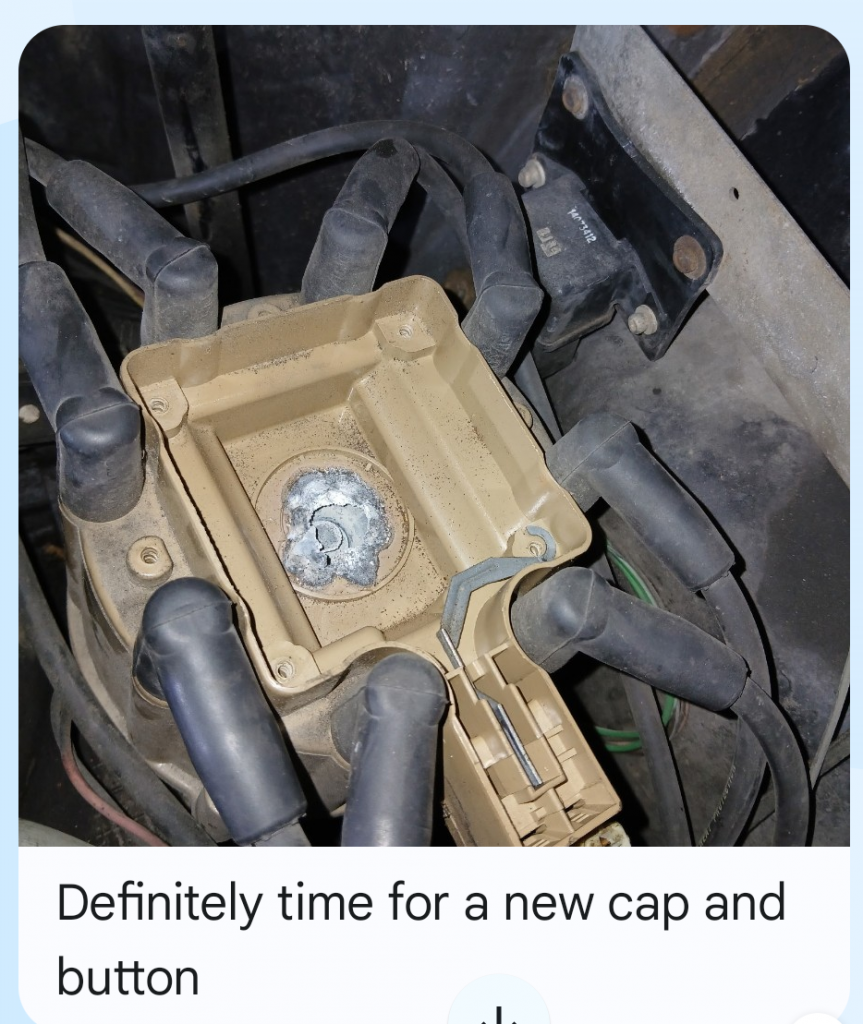

If this truck still has the "big cap" HEI distributor, those are noted for burning up the coil and the module or pickup coil, if the rotor burns through. It can still run if this happens... just maybe not real well.
Here are a couple of pictures of my neighbor Paul's 84 Caprice, when this happened....yes the car was still running before he changed the cap and rotor. He thought he should maybe look at it, since we had been working on my truck, and changing some of the same parts. The neoprene gasket/washer that's supposed to be under the coil....just gone.
