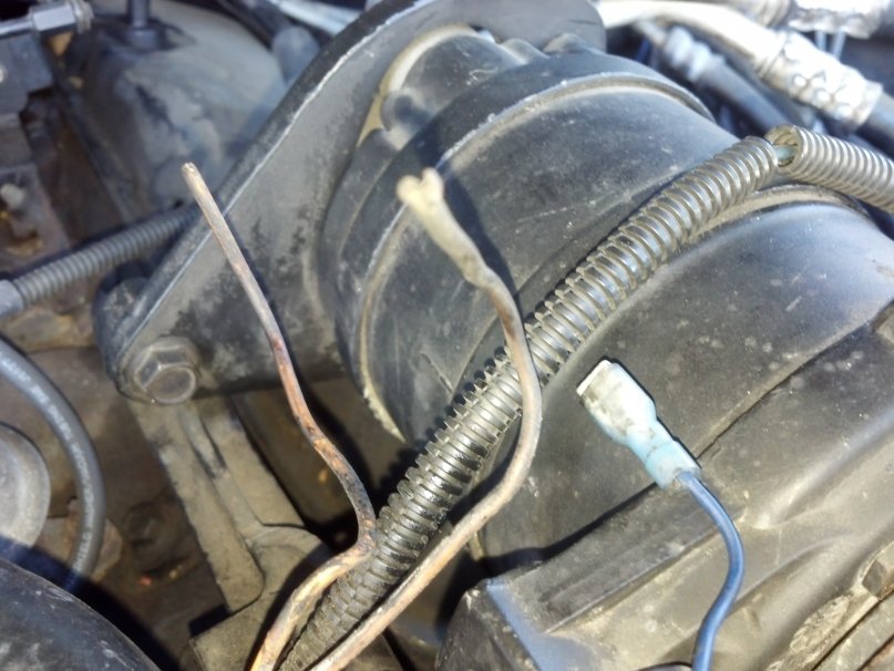

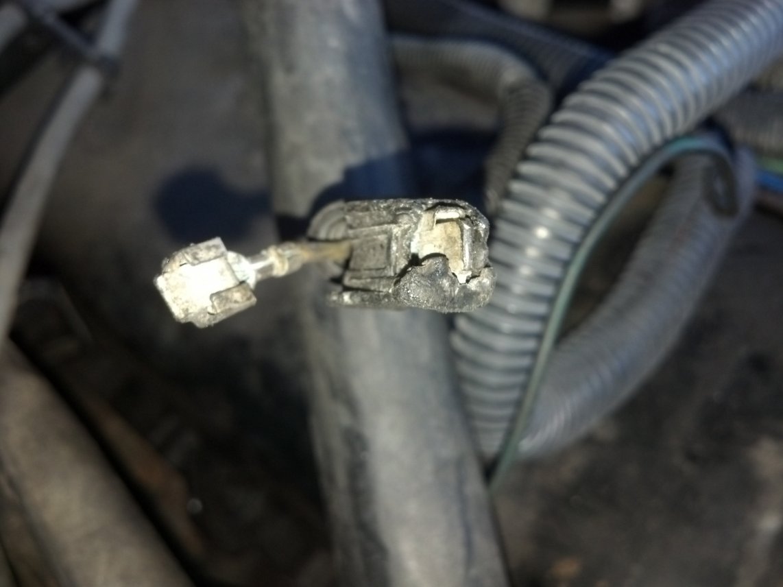

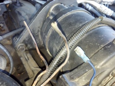

I bought this truck a year ago and I'm still going through it trying to repair things. In the first photo, I found 3 orange wires. One of them turns into blue which connects to the oil pressure switch. The other two orange wires were cut off. I'm assuming these are the wires for the electronic oil pressure switch. I will check through the charts above to confirm. Then in the 2nd and 3rd photos, I found this other connector all melted and also covered with tape hiding near the passenger side of the throttle body. I have NO idea where this thing belongs. If anyone knows, please let me know. Thanks a lot. And thanks you everyone for the great info. It is much appreciated. :headbang:
