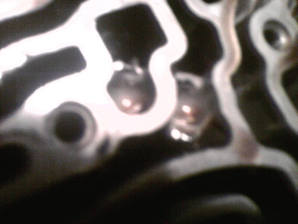

are there any tranny guys here
i started tear down on my 4l80 and after getting the valve body off and pulled the check balls i notice the holes in the case where the check balls sit are smashed out.
is there a fix for that or is my case junk
its hard to see in the picture but the cups are mushroomed out

As you suspect, you cannot use new steel balls in conjuction with distorted seats - the contours won't match up, and they will leak past. You might want to try these plastic balls, they are slightly flexible which allows them to conform to the valve body. By all accounts they work pretty well - for awhile.
Steel check balls are hard and heavy, wearing separator plate ball seats from the repeated high impact of the ball on the seat.
The new Sonnax check balls 10000-08 (.250") are made out of tough, wear- resistant imidized plastic. The Sonnax imidized plastic balls seal better than steel balls because they conform to the separator plate ball seats. Elastomer or rubber check balls seal well. However, the elastomer material wears, reducing the size of the ball.
Similar imidized plastic balls have been used on some original equipment late model valve bodies with excellent results.
http://transmissiontechnologies.com/10-imidized-plastic-check-balls-automatics.aspx

ya i seen them plastic balls and was going to get some 7 bucks for 10 of them
but the seporator plate is not my problem that is my transmission case that is blown out the plate actually does not look to bad
i have not found a fix yet or even heard of the same thing happening to anybody else
i think my case could be tig welded to build it back up then shape the cup and polish it back up but i will just find a new case
unless someone knows any other fix for my problem

i have not found a fix for the check ball damage to the case
i found a 97 to 03 4l80 case on ebay for 114 bucks shipped bought it and i had made a deal to buy a core 94 4l80 local for 150 bucks
so either way i will try my hand at rebuilding one and see if i get it right
i bought a manual that covers updates and the rebuild but still would like to hear opinions on what i should upgrade
plan to get the transgo hd2 shift kit already any other ideas
