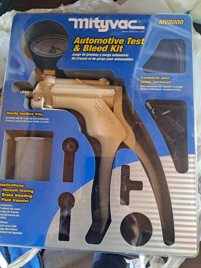

1978cheynne
Apr 9, 2025
5
idaho
shyla
383 stroker
Thanks guys it took about 4 or 5 rounds with the vacume pump on the bleeder on the slave . I built pressure then broke the bleeder loose. First time I used a vacume pump works great and by myself so that's a plus. I bought the good one I definitely think it's worth the money. Clutch feels great , drives nice

I could never get vacuum bleeding to work. For me it always pulls air around the threads of the bleeder rather than drawing fluid out.
On my last British car clutch I had to drip-bleed the clutch to get any pedal - no matter how much we did "have person 1 pump and person 2 open/close the bleeder" we did it would not get that last bit of air out. I had to dismount the slave and hang it on stiff wire so the bleeder was pointing absolutely straight up, and then left it dripping for 20 mins. After that, great pedal appeared.
Sounds like master on a LM Mustang. Can't be bleed on the vehicle. New are full of fluid.
