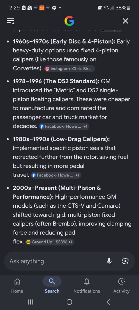

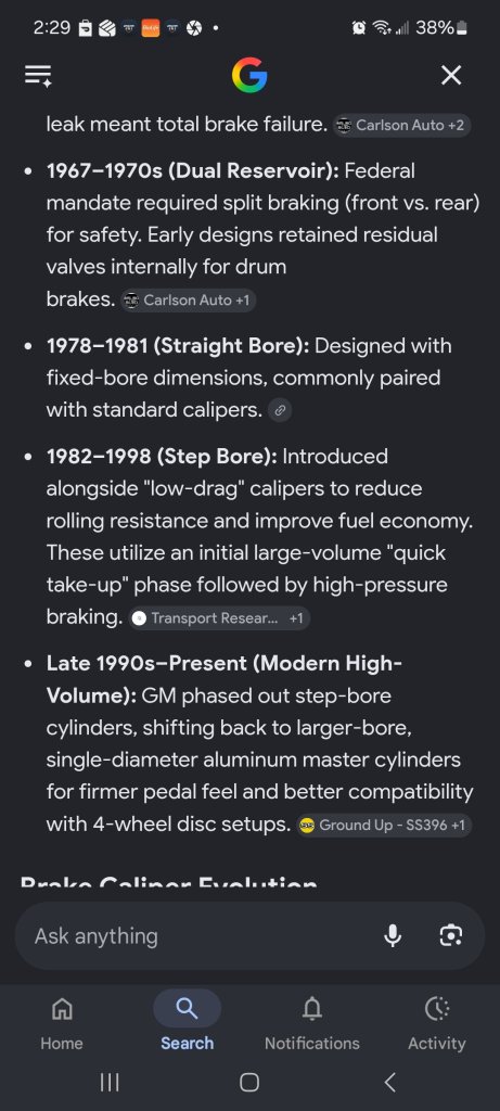

Newer master cylinders are designed for low drag calipers,the bore designs are changed.
