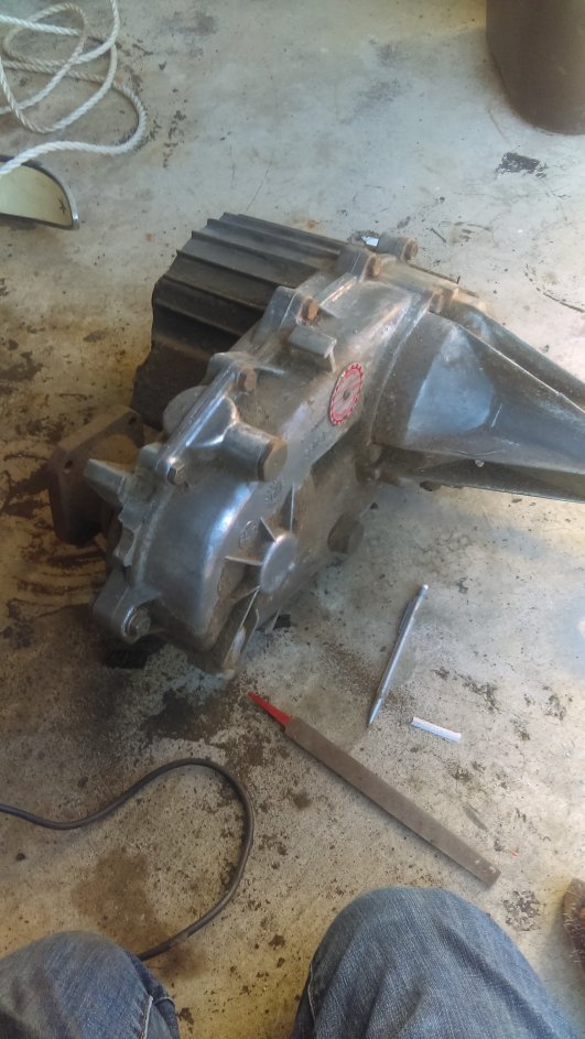

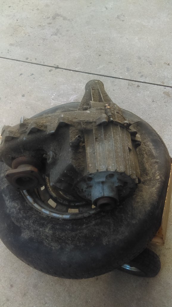

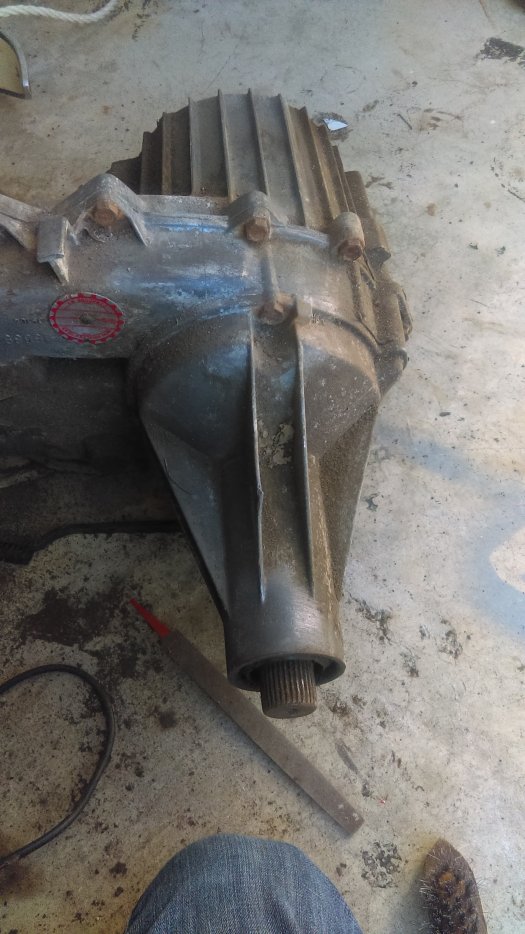

I just got a np208 t case and I have a stock 2 wheel drive tranny I want to use the thing is is that I have a 32 spline t case and the tranny is 27 I was going to put a 2 inch spacer on the tranny then get a inch cut off take the t case apart and do the input shaft new oil all that stuff and bolt it on I hear a th350 is a really good tranny so I see this setup being really good but thing is will I have to mod my back drive shaft I have a front one that adjusts so that ones good I'm doing a swap on a 84 c10 and I want to use my stock tranny what's the best way you guys think other then this idea trannys aren't cheap around here so I'm not getting a new one

If your front shaft is from an np208 truck it should work... IF you are mounting the front axle in the stock location exactly.
Rear shaft will need modified/replaced. It will need shortened and the front slip yoke replaced. If you currently have a 2-piece shaft with a center carrier, you will just want to eliminate that and have it tubed as 1 piece.

I have a I piece and yes everything will be in stock location and I'm going with a 2 inch spacer and then cut a inch off if will be a 6 inch shaft what I need then for the t case it's 32 spline I have to change that out to a 27 spline probably $200 in parts it will be a good set up
