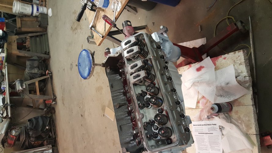

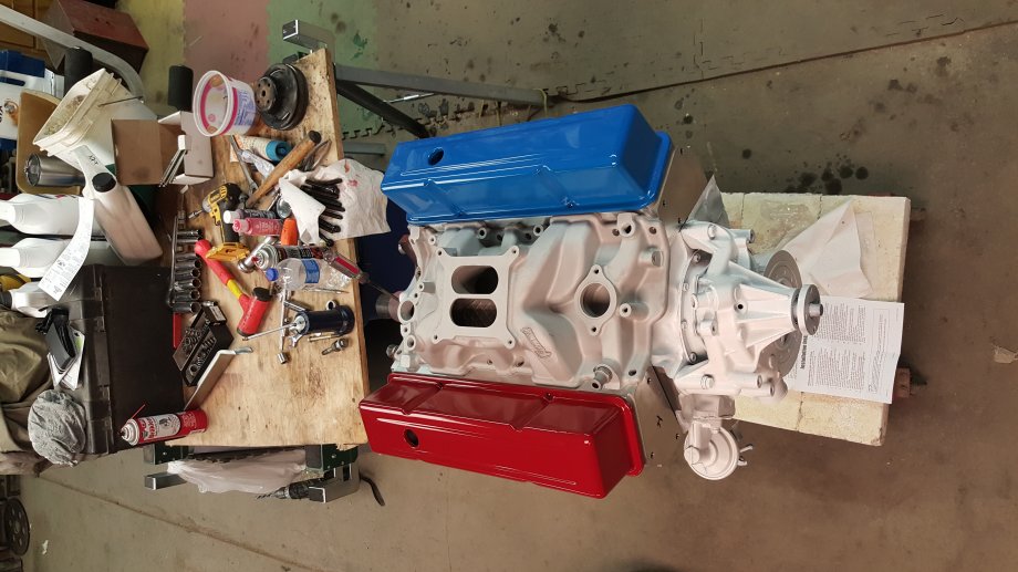

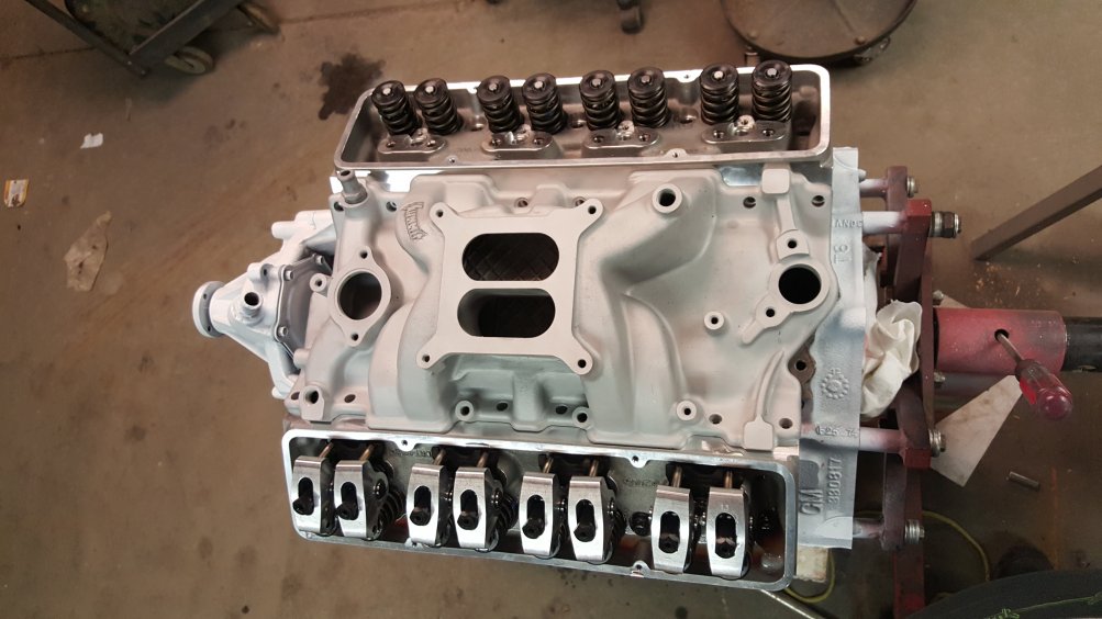

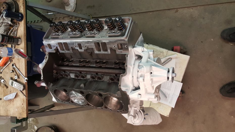

Spent some time today working on my build. Made a little progress. Another solid full day of work on it and it should be all ready. Gotta get my q-jet in the mail so it can be rebuilt. Will probably use the edelbrock that's on my current motor until I get the q-jet back. Waiting on a hydro dip kit to show up so I can dip the intake manifold. Once I get that done I will finish assembly and then I have to get the electrical for ,you new gauges done before I install the motor.

If you're gonna run a qjet on that manifold you're gonna need an adapter.

Yup already got one delivered from summit :) hoping to get the intake dipped tomorrow and then mounted up Saturday. I go back to work Sunday morning so the engine swap will have to wait until Thursday.

Nice, looks like it'll be one hell of a motor. Just have mercy on those poor tires.

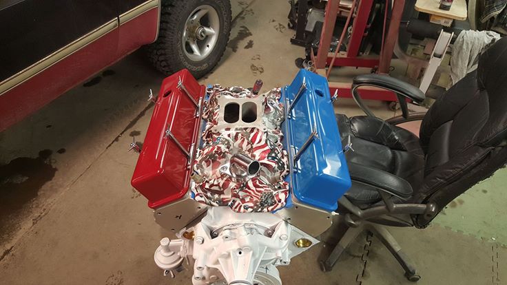

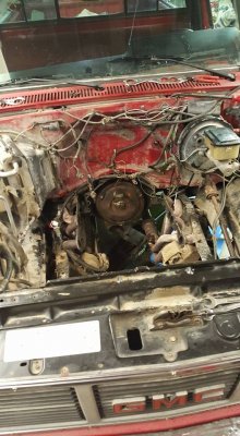

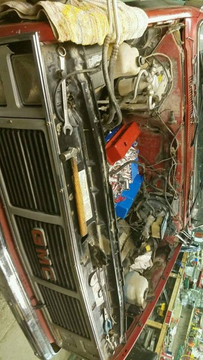

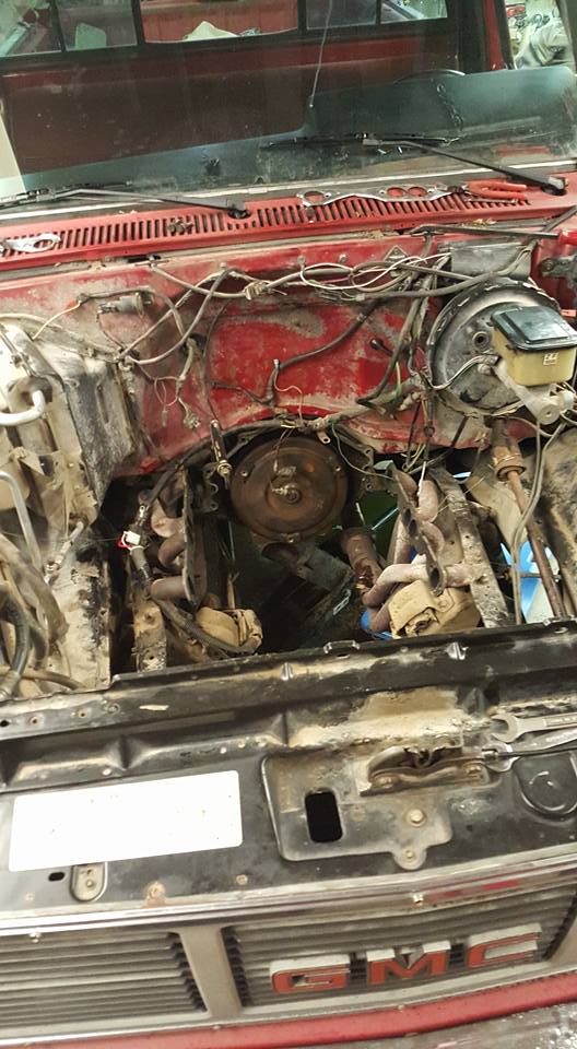

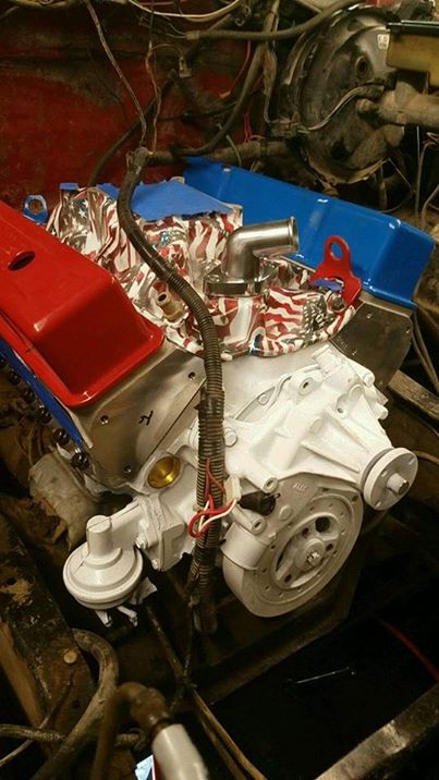

Made a little bit of progress today. Yanked the old 350 out and dropped in the new 400. While I was pulling the 350 I realized the transmission fill tube was broke and only being held on by one of the bellhousing bolts. Gotta get one ordered. Back to work tomorrow night for a couple night shifts. Thinking Thursday I should get her up and running for the break in. Still gotta bolt up the headers and then mounted all the accessories on the front, but that should go decent I think. Also ended up replacing the steering gear box while I had the motor out.

Well the motor is in and broke in. Just gotta do some small things like the the plug wires all routed where and how I want them. Also going to have to make a bracket for my ac pump because the taller valve covers on the motor will not allow it to sit where it used to... whole I was doing the break in I climbed under the truck to look for leaks and found a giant crack in the bellhousing of my 700r4. Fricken joy... anyways, spent half the night online looking for a new transmission, decided to stick with a local shop. For about $1600 the guy is going to swap the case and rebuild the transmission so it will handle the power my motor is putting out. I was able to find them cheaper online, but the guy who owns this shop is a family friend and he does great work. We've used him for as long as I can remember and he has always treated us very well.
