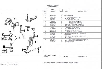

I am kind of late but I have this exploded view. The original is much larger sorry.
