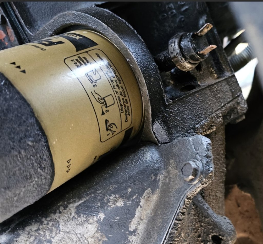

An electric choke opens via heat from an electric element. It closes by tension on a spring which losses tension as it heats.you don't need engine heat to open your choke. As for how to power it there are 5 ways I can think of but only 2 I'd actually want to use. 1 is a 4 prong relay terminal 30 to battery+ terminal 87 to electric choke,terminal 85 splice to alternator terminal #1 terminal 86 to ground. The relay will close and provide power to the choke,only when the alternator is turning at speed. Option 2 use a normally open 2 prong oil pressure switch it will close with oil pressure. Provide 12 volts to 1 side the other side to choke. As for your choke closing you need to loosen the screws on the choke housing and rotate it until it closes the choke plate. Don't set it so tight it is closes completely leave a gap about 3/16. I am going to give reread your essay and see if zi can help sort out your other electrical mysteries.
