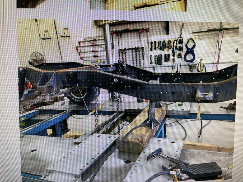

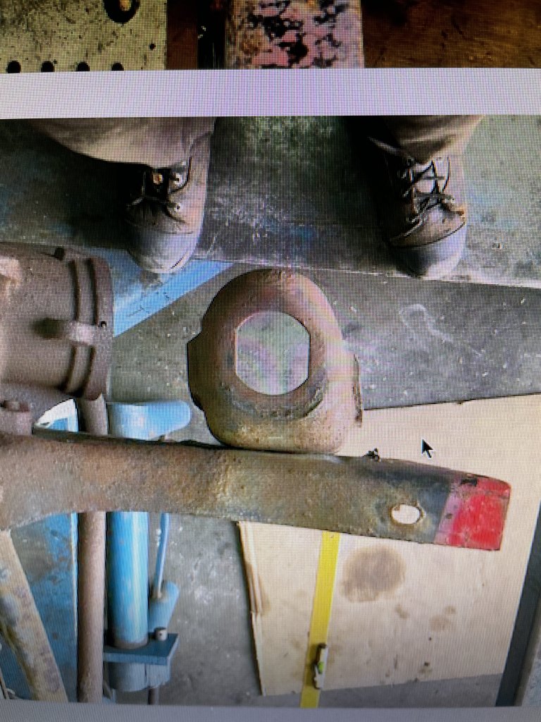

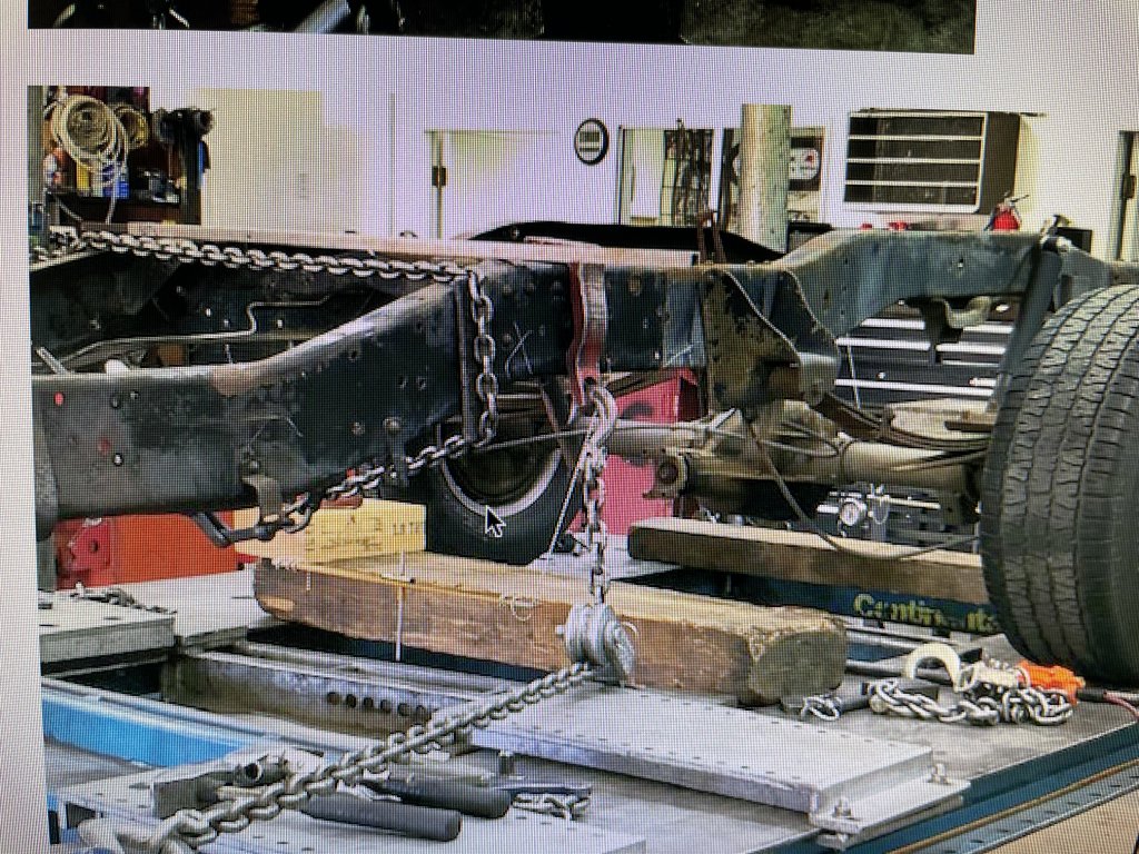

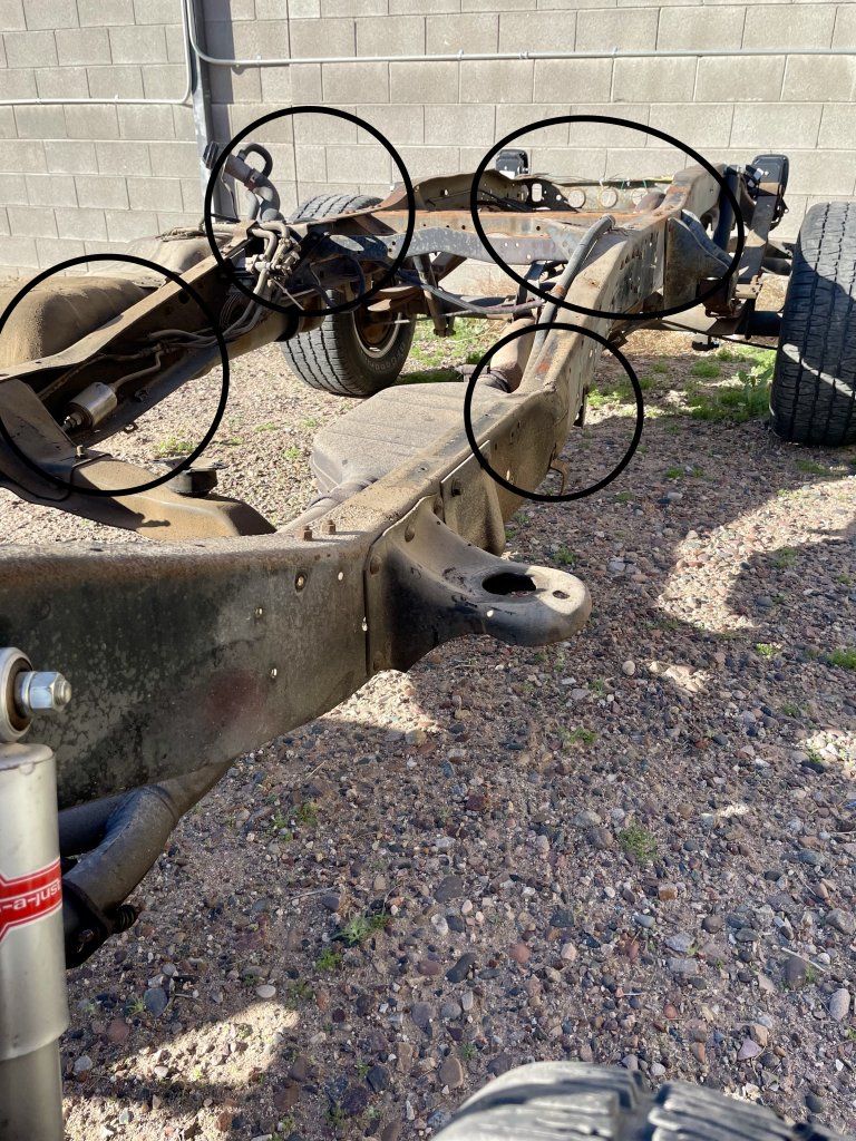

Getting it to a competent frame repair place is the first step. These trucks when hit in the front transfer the energy under the cab and you can only straighten what you can get to. I have attached a couple pics of one of my trucks and didn't look at it carefully enough when I bought it. Only after I dropped a fuel tank did I realize what I got into. Note the rear cab mounts, they bent them upwards to get the cab and bed to align while sucking the bottom of the frame in.
After a year of looking I could not find a used frame worth using so this was the only choice short of aftermarket. With me handing him a rolling frame, he charged me $2k to straighten it out, this was over 2 years ago. He returned it to me like it was never bent. His work was excellent. No heat or hammer marks. Came out so good I had it powder coated .
The first thing I did to understand how bad it was, I put it up on 4 jack stands and made sure they were all at the same height. I found frame measurements on line and went under it and started measuring. Used a line level and a plumb bob to figure out what was going on.

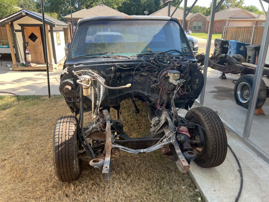

That’s hope full I did the same bought truck didn’t look hard enough and striped it down for swap and I started noticing when I pulled front clip how bad it is. Then when old motor came out I realized the frame had been cut and welded back.
So next week I will remove cab and bed and take to a frame shop!
Any suggestions for the north Texas shops! Or any advice on how to choose one.

In today's world, not many places want to get tied up in our projects, they want quick and easy insurance money. I would start calling around. The guy that did mine was a "frame repair" shop. He didn't do anything else, no paint or body work and only light mechanical to perform the frame work.
