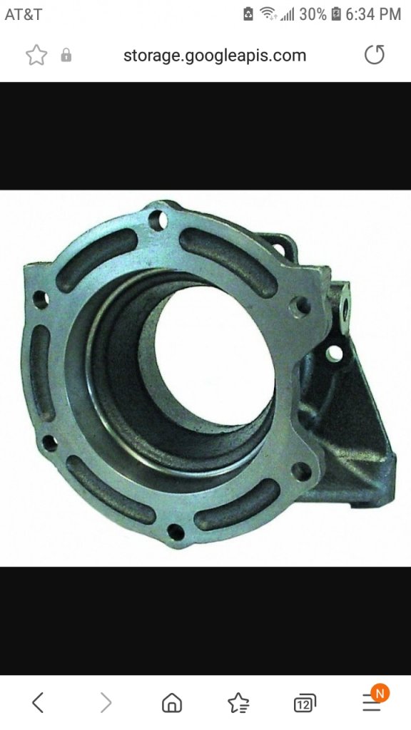

I am looking to buy a round bolt hole adapter with threads on the passenger side for the pivot on the transfer case shifter. I hope someone can help me out on this
Thank you

They are out there, but, they are expensive.
The biggest problem is the adapter to take the transfer case shaft to the transmission shaft.
I think they usually come as a set.
Last I checked, about $1200.00 IIRC.
That was why I sent My NP205 to HRPC because I could not afford the adapters.

There is no drive sleeve on a th400 / np205 set up, the tcase input is female.
