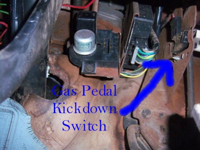

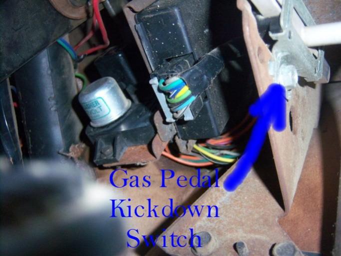

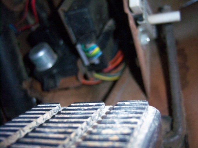

Look at your gas pedal assembly for a Th400 kickdown swith to see if its even got one first of all, then we'll go from there.
attachment.php
attachment.php
attachment.php

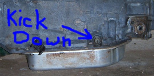

Drivers side of trans toward the tailshaft just above the pan.

I got a bit of time now for a better more detailed explanation, and to answer all your questions.
NO, Kickdown switch on a Th400 will NOT change your problem. Now it would if you floor boarded the gas pedal everytime you took off, cuz the Kickdown switch will override the vac modulator. Hooking up you kickdown on a Th400 will do nothing but give you kickdown. Its electronic, and its either on or off. No in between. As said above, lets find out what you have in the truck as far as the swtich and the wires, and we'll go from there on hooking that up.

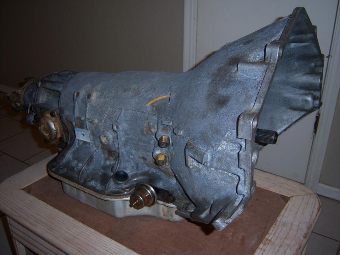

No, do not need to change fluid, pan, converter or nothing like that. Your problem with early soft shifts is nothing more than a vac modulator adjustment or failure. There are 3 types of Vac Modulators. One is a biggo dude about the size of a coffee cup with a small very noticeable screw in the back of it, usualy painted black but can be other colors. Those are old style and not used or seen much today. Then there is small bulb type that is usually brass. Some are not adjustable. You can tell these models becuase if you look in the end of it where the vac line connects you will not see a small screw. If you have this type without the screw and having this problem, you'll need to replace it with the adjustable cousin. The 3rd type looks just like the 2nd type, small brass bell or bulb type as I have pictured below, and usually has a red stripe around it. I'm assuming that is what you have since its most common now days.
Th400 relies on 2 things to detemine shift points. 1 is the governor which monitors tailshaft RPM, #2 is Vac modulator. That's it. The vac modulator is what tells the trans what kind of strain is being put on the engine and when and for how long to wind out the shift points. Yours was probably never set. It was just taken out of the box and bolted on without adjusting it. So its set real sissy like with a very very light spring, so the vacuum overcomes the spring very easily thefore the vac mod valve is telling the trans to shift way early. Remember, less vacuum actually holds the gear longer. So when you romp on it, low engine vac will not allow a shift, but governer will take over so you don't go to high of rpm. And if you had the vac disconnected, like no vacuum, then it would shift very very late and very hard. So you have the opposite problem. Just adjust the modulator or put an adjustable type on and adjust it, you're problem is solved. Vac Mod is on the passenger side of the trans just above the pan. It'll take you longer to find a screwdriver small enough to fit the hole that it will to adjust it. It'll take you a painless 15 seconds to adjust.
