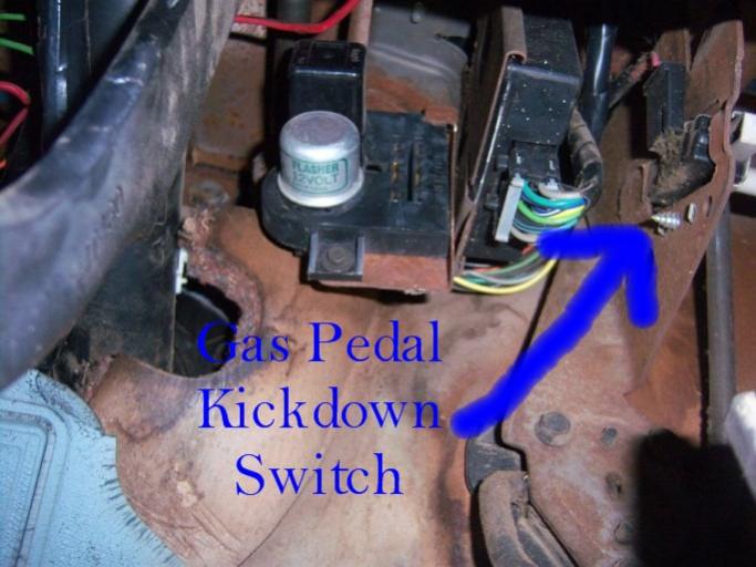

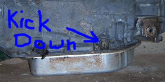

Have you got this resolved yet??? I just happened to be getting ready to post a thread in this section and seen your problem. Its a piece of cake. It is an electronic kickdown switch and your trans probably has it already. Look for an orange wire under the truck somewhere. But wait, if this was not an original T400 truck, it won't have it, so you'll have to wire it in yourself, still not hard to do. Here is a pic of the kickdown switch on the driver side of the trans, so you know the location of it. It should be a single spade.

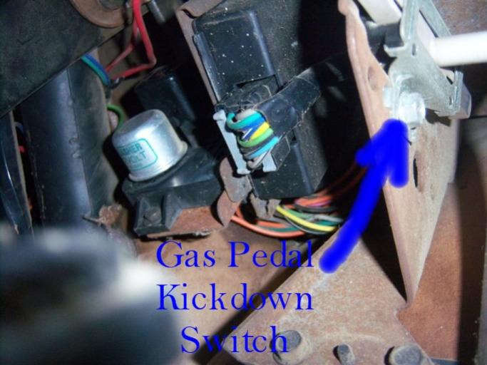

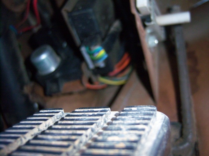

Here are some pics of the gas pedal kickdown switch. This switch is to be wired to the switch on the transmission. Pic #1 shows the left side of the switch where the wiring goes. Pic #2 shows how the switch mounts to the gas pedal assembly bracket. Pic #3 although blurry, will show you how it function. I think what I'd probably do, if you have a Pull a Part. Go to a pull a part and look for a 3/4 or 1 ton truck since most of them has Turbo 400's. There you should be able to rob the switch and possibly even the harness that goes from the switch to the trans. If not, just get the switch from a parts store install and wire it in yourself.

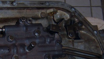

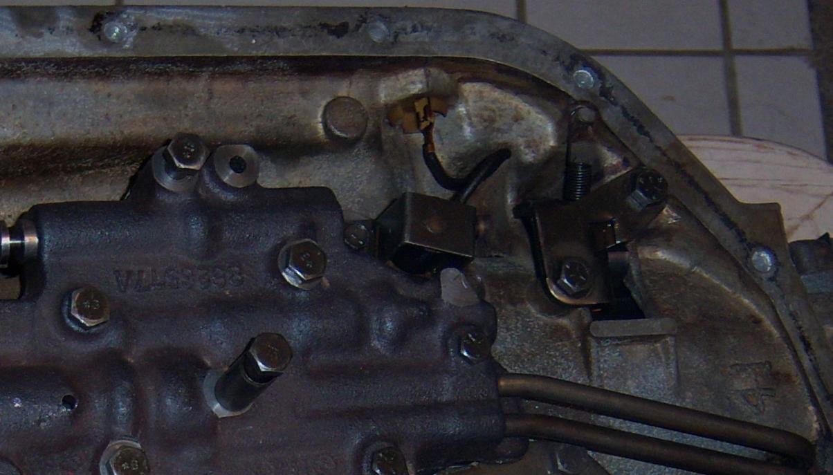

Nope, all you are wanting to do is wire that gas pedal switch, so that when you nail it, it activates the solenoid inside the pan near the valve body. That is the majic when the solenoid is activated it pushes a valve. I have even seen a guy put his to a push button switch also, so he didn't have to go full throttle to activate it. I guess whatever works, but if you are gonna do that, may as well just manually hit 2nd gear. Cuz my truck has such talls gears, 3.21's. My kickdown will go all the way down to first gear. So lets say I am coming up on a service rd to an on ramp for the freeway at 35-40mph, then I nail it to get on the highway, then it drops into first, and will stay there unitl 55mph then go to 2nd, if I keep it to the floor, and if I still keep it to the floor, it won't go into 3rd until something over 85. Maybe 90, I dunno for sure since the speedo quits at 85, buts its right there close to 85 or just over before it will hit 3rd. You'll sure like you truck alot better with it hooked up. What I don't like, is you have to go full throttle to get it to hit. I like the Turbo 350 cable better. I think it does a better job and is more adjustable. Now I have also been told the gas pedal switch is adjustable, and I should check into that, but I am actually OK the way it is, I am used to it now. There are just time when I'd like to go half throttle pick up a little speed and have drop into 2nd to get it there, but no, gotta go full throttle then instead of gradually gaining speed, you gain it quick and waste a gallon of fuel in a 454. Not you have need it, but here is a pic of that magic solenoid that is inside the pan. You can see the wire where it goes to the plastic switch inside the pan, and then of course that is where the spade is for your kickdown on the outside of the trans.
