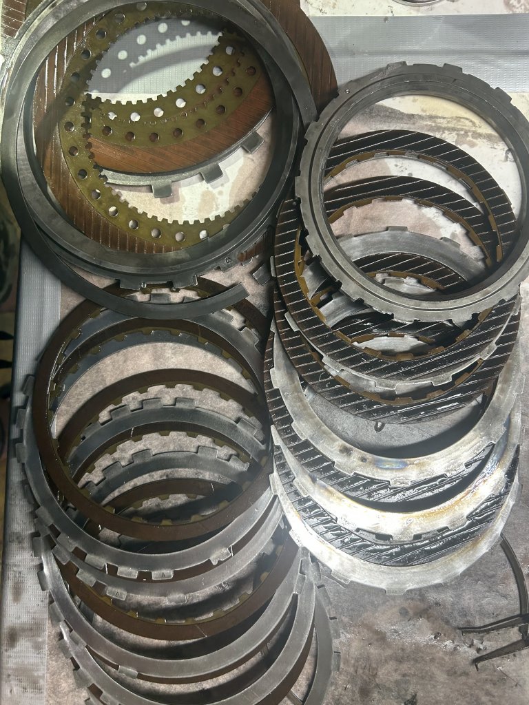

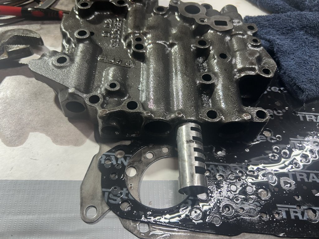

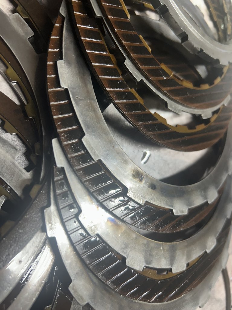

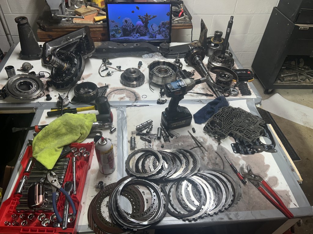

Made a thread a couple weeks ago about running dry on atf and losing all drive gears. Community said “yank it for overhaul” well, I’ve got it torn apart and I’m not sure where the issue was. I have a couple pictures to share and ask opinions on. One is of all the clutches. The ones up top seemed burnt looking but I’m not sure if that’s enough to have caused me to lose drive gears completely. Next is the valve body. When disassembling, one of the valves were pretty difficult to get out. Took quite a bit of turning and pulling when all the others slid out easily. I took a picture with the valve sticking out of the slot that was being a pain. Maybe this was the issue? I appreciate any and all input. Simply asking opinions on what could’ve been the culprit for no drive gears.

The clutches have definitely seen some heat, but they aren’t burnt. What’s the pump look like?

Direct clutch looks smoked but could be the lighting making it look worse than it is. Intermediate and Low Rev clutch look to have normal wear to some stress.

Oh! I was assuming the smoked one was the forward pack. I’ll do some more looking around and check a diagram to see where I should be looking. Very new to all this. Bear with me. XD

Maybe it was - you should have four clutch packs on the bench but I only see three so post a picture of the one not already shown and we will go from there.

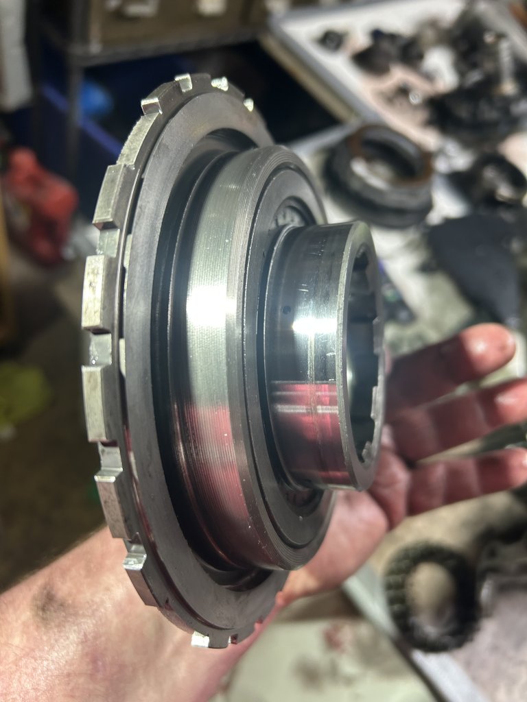

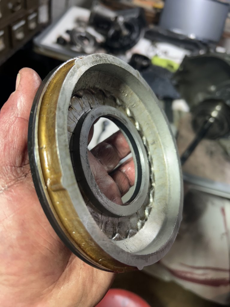

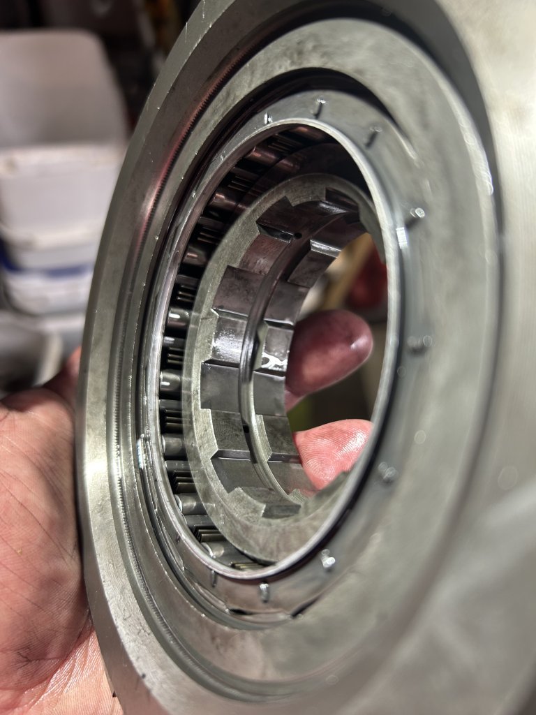

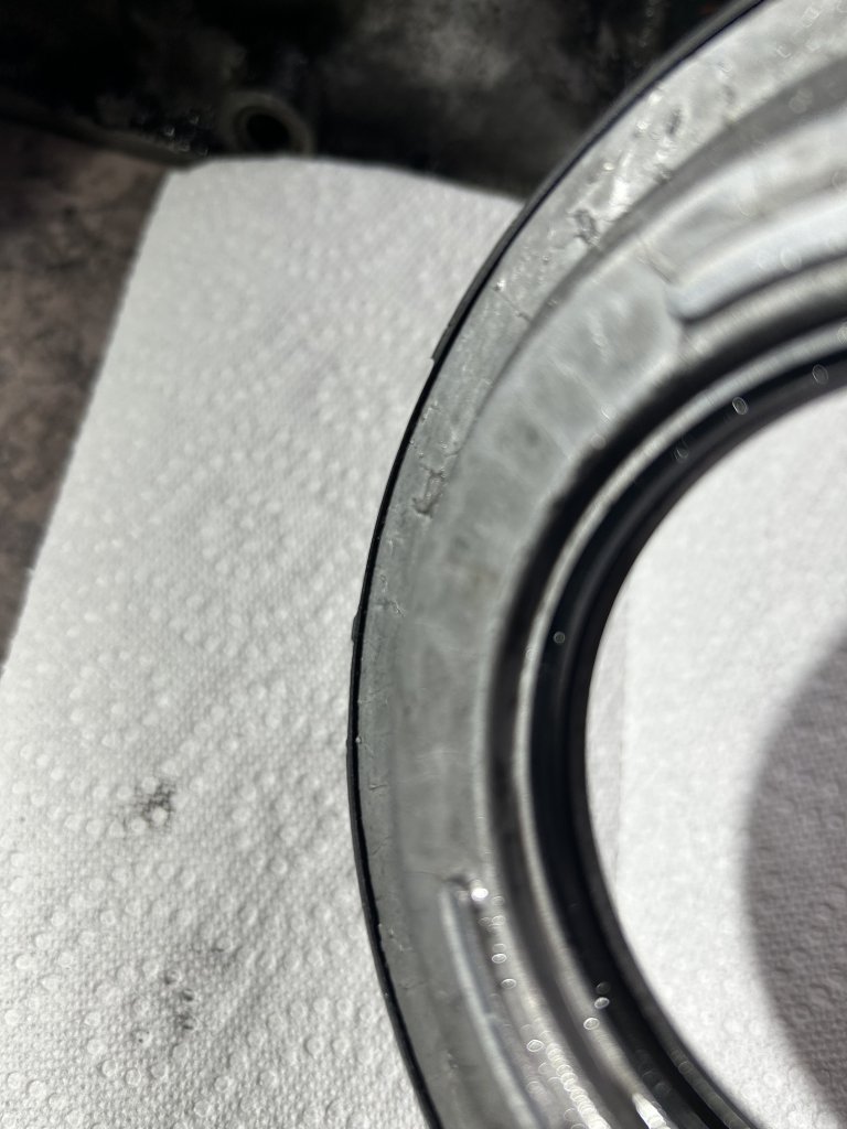

Took a few pictures of what I THINK may be the parts you’re asking about. Please let me know if I’m barking up the wrong tree again. One is of the piston. And one I believe is the center support and the low roller clutch? The seals on the piston do still seem rubbery and not hardened or torn across. One small bit is missing just a tiny bit off the rim. I’ll try to take another picture showing that.
That second pic does appear to show a cut forward piston lip seal. yea, take another picture but even a small laceration is sufficient to cause the damage sustained by that forward clutch. Also check the underside of the forward clutch pressure plate and see if there are no little indexing marks, one mark or two marks...That pressure plate is selective, meaning there's multiple versions of the same plate...if your clearance is not within spec (i.e. too loose or too tight) you may need to swap that plate for a different version to get your clearance...My video series on the transmissions discuss this among many other things.

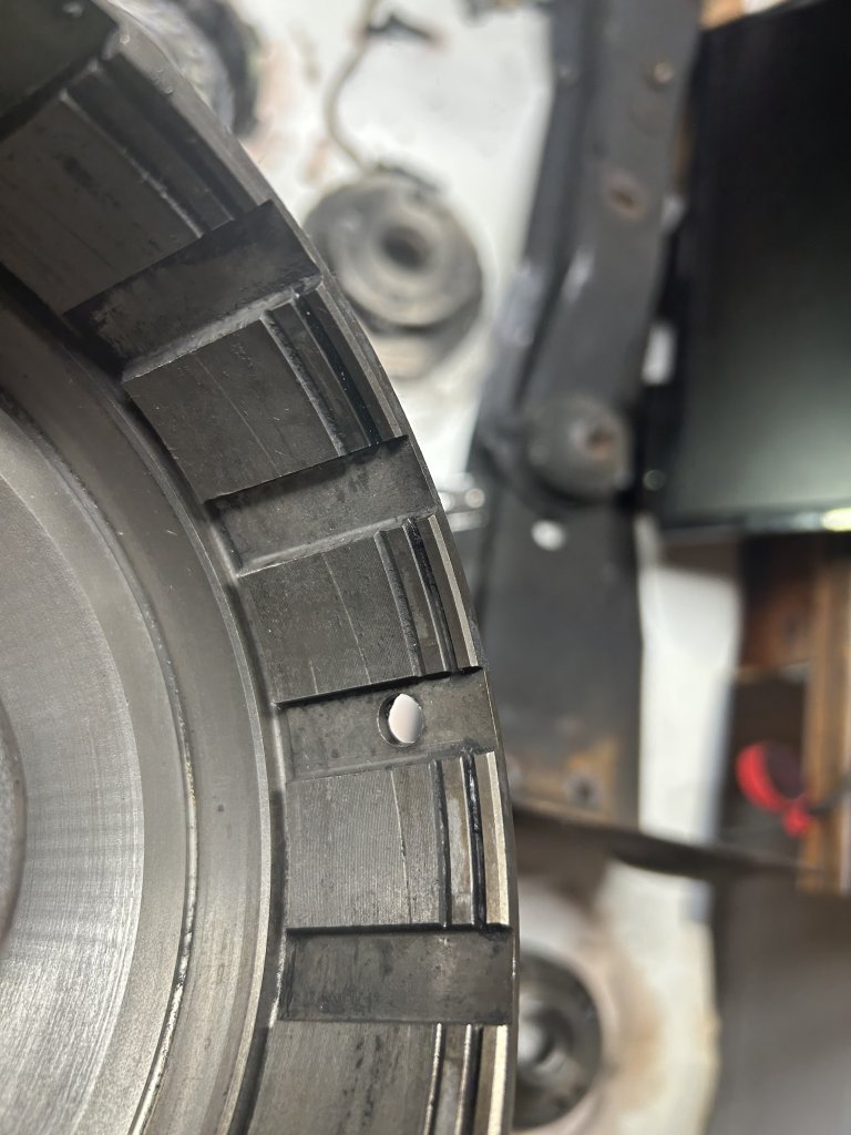

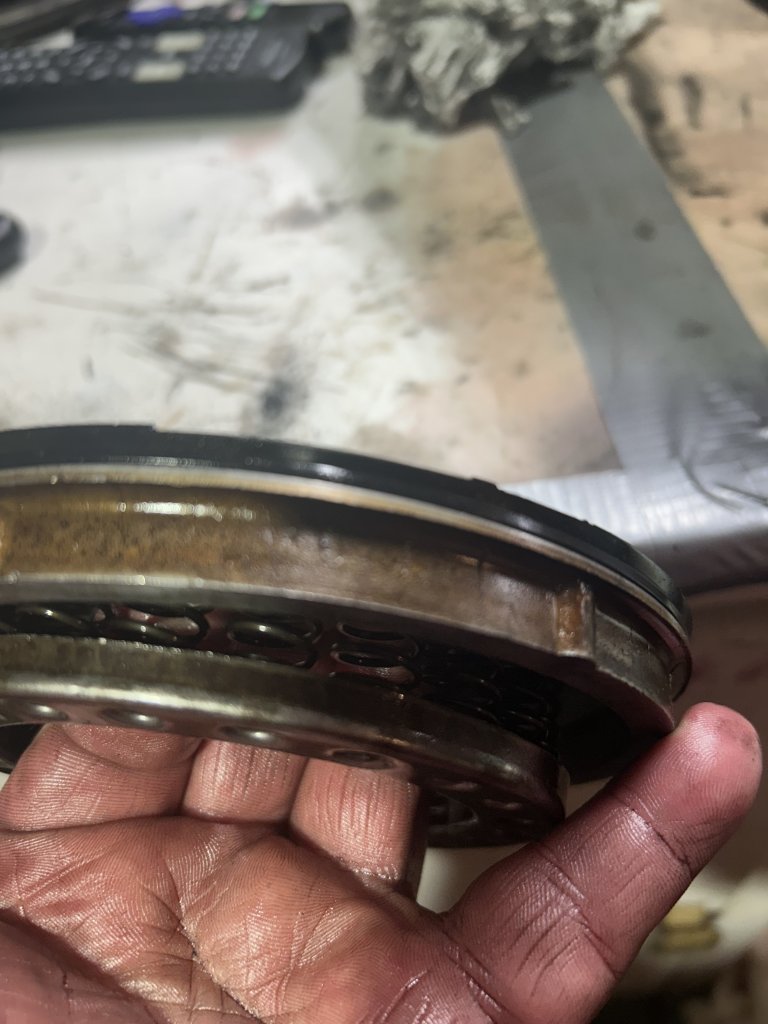

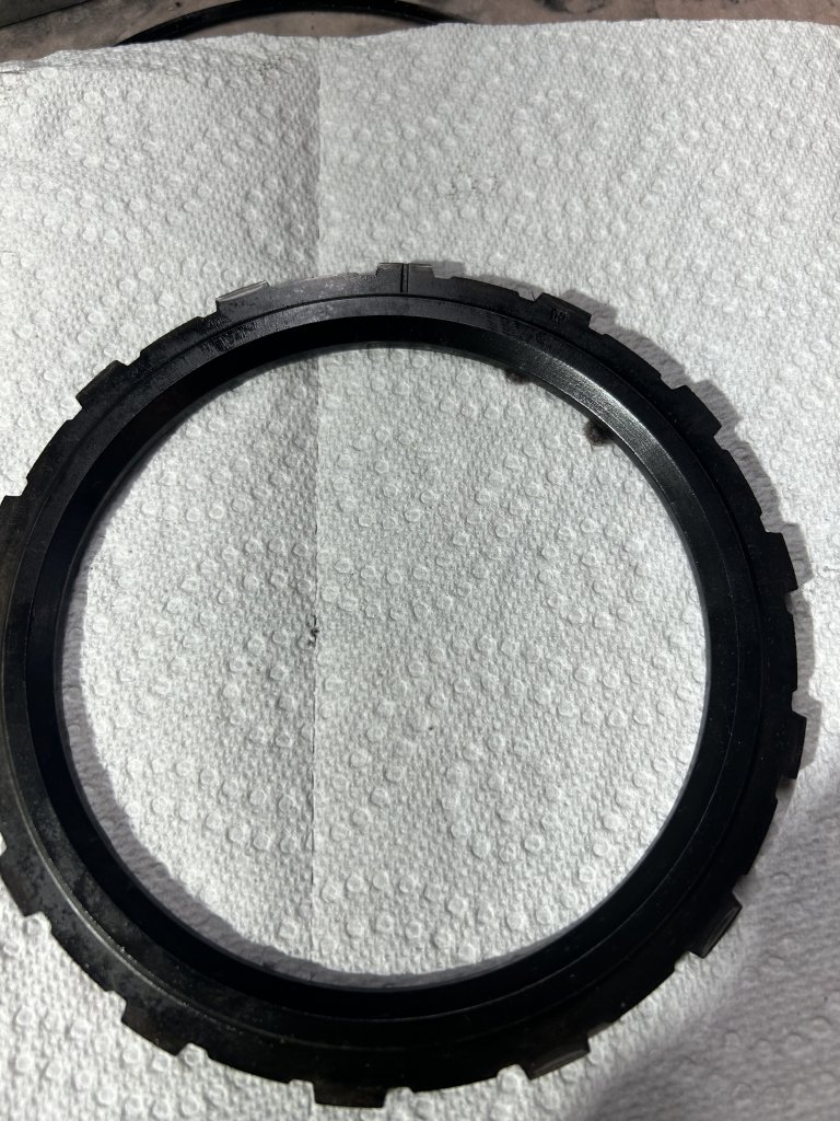

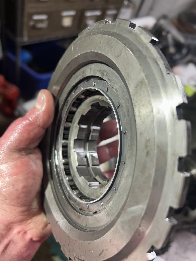

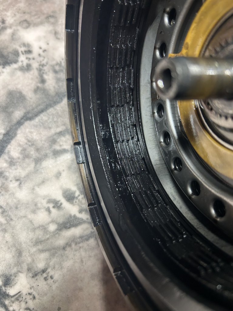

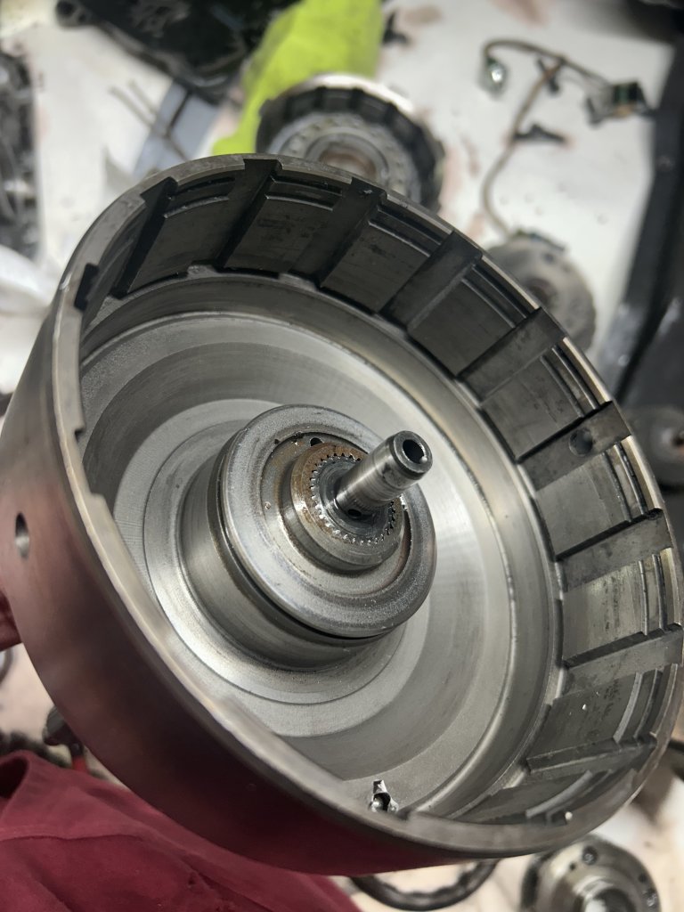

Here’s the forward drum after a little cleaning. There’s a gouge I’m not sure I should be concerned with. The rest looks great considering how the clutches look. Also a possible better angle on the piston and would this be the indexing mark on the pressure plate? I’ll be binging your series tonight sir!! And likely as I rebuild XD

At least now I know there’s something here. Those first clutches didn’t seem so concerning but WOW these are bare bones. Thank you for pointing me in the right direction. Was worried I’d get this all torn apart and not find anything wrong to find out it was an issue in the steering column or something
