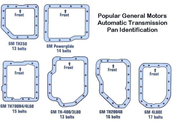

You sure it's a turbo 350? Turbo 350 has the kick down cable to the carb. A turbo 400 uses a switch at the gas pedal to control kick down. Here is a chart to confirm which trans you have.
