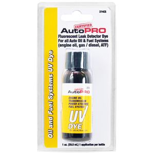

Dipstick, shift seal, modulator o-ring, TV cable seal and possibly the speedometer drive gear. But if it were me I'd try a leak detector die.

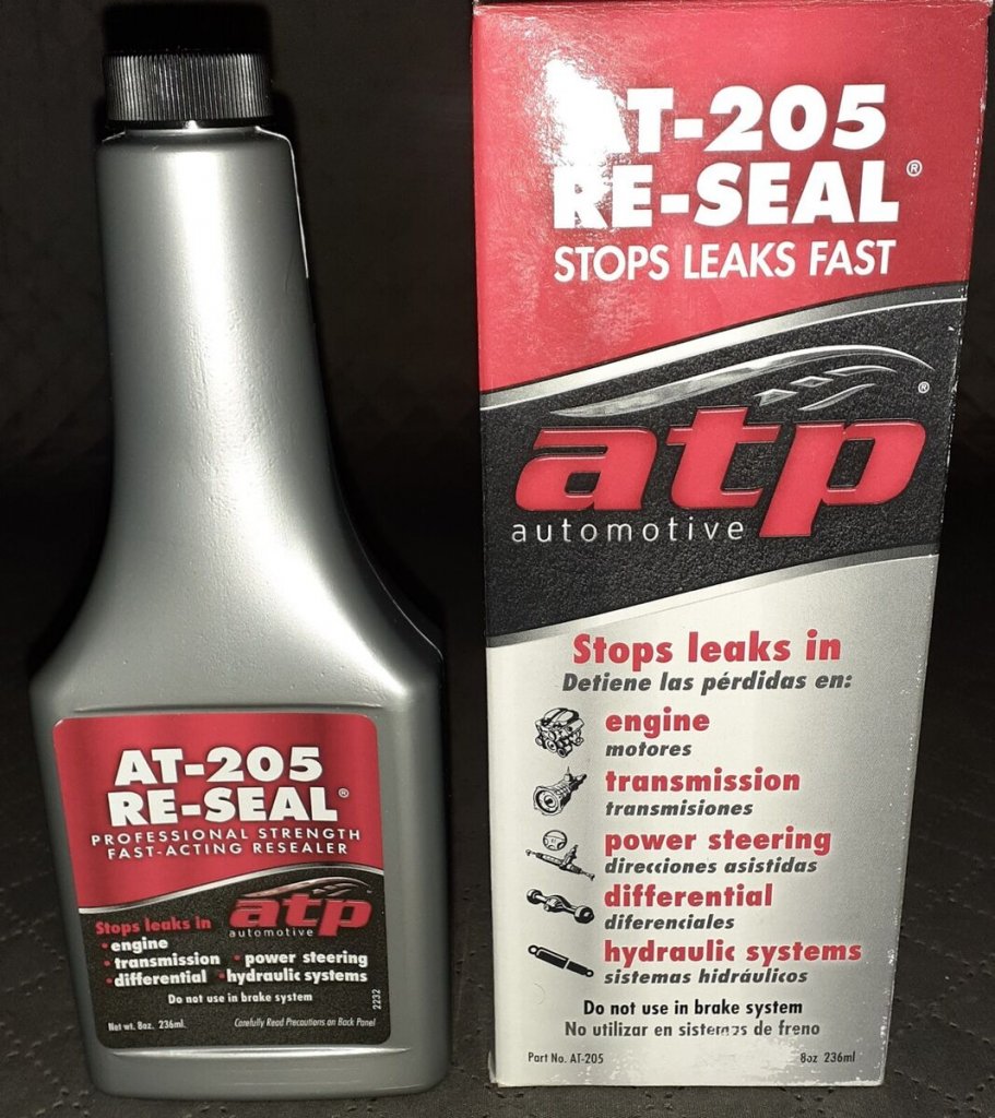

You seals are probably dried out and hard. When the temperature changes the seal cant form to the parts that way it used to and a leak happens. Once the parts cool down, the tiny gaps close and stop the leak. This is not the standard "stop leak". This is a specialty product. It does not swell seals or cause any problems. Its simply replenishing the missing chemicals that have evaporated out of the rubber, making the rubber soft and supple like it was when it was new. Works great.
What stores sell that stuff? I've never used it, but I'll give it a whirl.
Many auto parts stores do, but the most convenient seller is Amazon. Maybe $18 per bottle.
During the pandemic, the production of this product stopped due to supply chain issues.
I saw listings for $200 a bottle, and they were getting it. Its good stuff.
