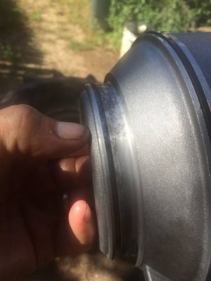

is there any reason this o ring is missing on the rear piston? is that a duel feed?
They do that so in theory theres more piston surface= holding force on the low clutch pack.
