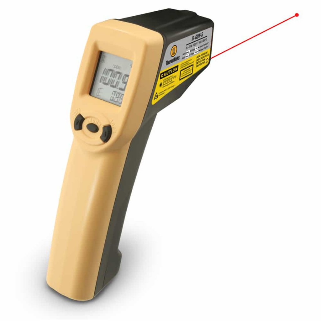

I agree, the numbers on the gauge don't really need to be there. Learning the needle position is what matters. If it were a clock with only an hour hand - Mine would run at 12:00 and go as high as 12:30. I flushed the system and changed the fan / shroud design, and clock went down to 11:00 and stays there all the time.
Also, for about $13 you can get one of these on Amazon, so that you can see what the gauge position actually means:

@Edelbrock I have a Temp Pointed at the Temp Sending unit read 150 ish Would that be a good Location to check?
Chevy 88
Mar 28, 2025
783
792
Canada
f7t6
GMC
Its best to take multiple readings from different parts of the engine, but you want to stay away from the exhaust manifolds / headers.
What ever area gives you the highest reading is the most accurate temp. The inlet of the radiator, various spots on the intake manifold, front of the heads, etc. Doesn't hurt to take a temp reading on the bottom of the oil pan, just for a more rounded picture of the overall engine temps.

After it's been running for a time thermostat housing or the area near stat on intake. Reading will be slightly lower than actual coolant temp.
