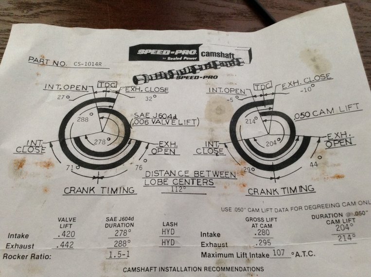

Ok I'll put the egr back on and test it while it's runny I never heard of it so no biggy I'll give it a shot. And it's not a stock cam but it is a stock rv style camshaft. I got it off of northern auto it's for the "k" series truck the website said it is computer compatible
Hmmm...I had this problem with my Comp cam, which was problem free in my Tuned Port setup. I ended up sick of the programming of chips, so I just set the minimum idle setting to 50 more rpm than recommended.
