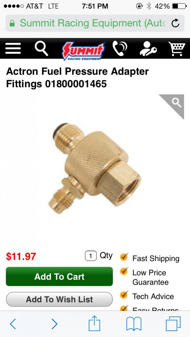

You've done everything that I can think of. There's a little something I can think of that I'm gonna buy in the next few months to ease diagnostics a little. I'm thinking the pump is doing too much or too little and/or the FPR is messed up. Have you rebuilt the TBI before? It's only a thirty dollar kit. The fitting that I screenshot screws in behind the TBI and the line screws into it.
