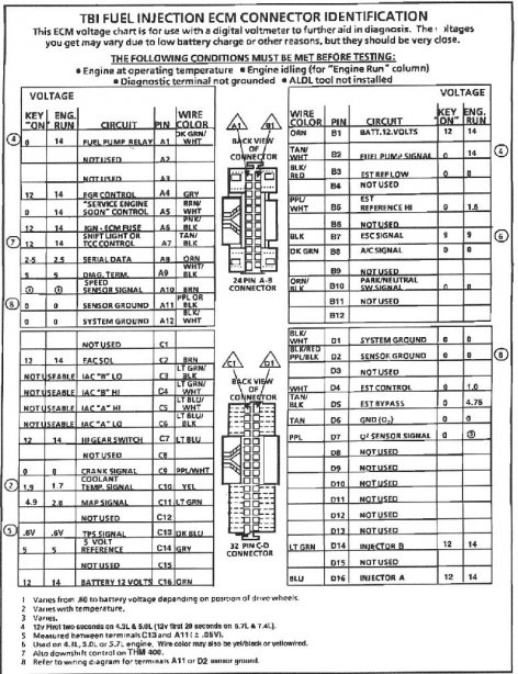

So i played with it some more today. I got out the DMM and started probing things. I found diagram of the 747 ecm which is what I have. Ill put it in the attachments. Pins A6 B1 C16 all have 12v+ KOEO (key on engine off). D14 and D16 are the injector terminals and also have 12v+ KOEO which is expected. Pins A11 A12 D1 D2 all have 12v- as expected. Based on the diagram there is no other power/ground connections there. While cranking or running there is no ground pulse on either D14 or D16 when there should be.
So far what I think may be causing the issue is the TPS pins on the ECM. I checked them and pin C14 TPS 5v ref. read 12v-. Pin C13 TPS signal that should be around .6v+ throttle closed read 12v-. Opening the throttle did not change anything. Unplugging the TPS brought C14 down to 11.8v- and C13 down to 11.5v-. So not only are they switched from hot to ground but the voltage is way off. I dont know what could cause this except for a bad ecm or possibly a wiring issue. The wiring in stock form doesn't have any spliced sections in it and this harness hasn't been molested (yet).
What do you guys think. Think I may be missing something. Is there a way to check the reference signal from the ICM to ECM. I'm assuming its a very low voltage square wave signal that I couldn't read with out an oscilloscope which I don't have. I will continue researching and will update with what I find.

Finally solved it. pIN C16 was bad on the ECM. I was measuring everything from the harness plug which check good. First look at the connectors looked fine but they weren't. I took apart the ECM and started checking everything from the back side of the ECM plug and found C16 wasn't getting any power. I pulled it off and tried to clean the pins even though they looked OK and it broke right off flush with the plug. It was rusted all the way through. I attached an alligator clip to the back side and and the battery and it fired up immediately. TPS voltage works fine and SES light is back on. I'll get a new ECM first chance I get. I'll just solder a new plug on if I can find a replacement.
