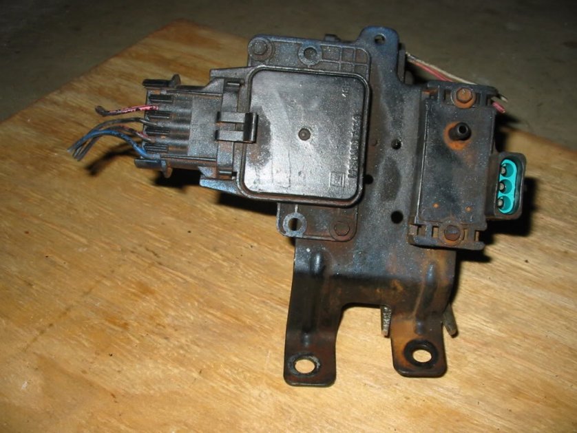

The ECM that you want is probably gonna be a 1227747. That's 87-92 trucks without an electronic transmission and with an external ESC module. Don't buy it from a parts store because it won't have a PROM. I say go to a junkyard that has square bodies and GMT400s and get you one. That or go on eBay. It's a gamble, but worst case scenario you have to buy a remanned one from the auto parts store and transfer the PROM into it. Also, make sure that it wasn't a '92-'95 truck with an internalized ESC module. It's highly unlikely since it was a manual, but I've been helping my brother work on a '93 Z71 that he bought that has a hick 4.3 to SBC swap. The TBI stuff is all mixed and matched so I'm just saying you can't be too careful. The module is on a carrier on the passenger side of the intake manifold. It has lots of pins on it. Manual versus automatic only matters on the later OBD I computers since the automatics weren't computerized until later. And they say Walbro is the best in-tank pump. Hope this helps.

It should have the ESC module since it was a manual. It's the little module with the plugin that has the cut wires.

Yeah, that's the EGR solenoid. I'd just keep it instead of fooling with tuning it out of the ECM. Are the two ECM plugs blue and red or not color coded? The 7747 won't work with the color coded plugs. The fact that you don't have a ESC on the outside leads me to believe it had it in the computer so the model number computer I gave before wouldn't work. You can search the number on the TBI, also, and maybe that'll give you clues. This worries me because my brother's '93 is the same way, and it has a 4L60E. The only way to get them is with the ESC on the outside and no provisions for a transmission or with the ESC on the inside and transmission control. The worst this will do is a Code 74 maybe and whatever else goes with the transmission. Plus the TCC solenoid as mentioned before. I'd hold off until you found out the year of the truck it came out of because it's not gonna do right with the aforementioned model computer if what I've stated above is the case. These aren't dumb questions, though. I don't want you to get the wrong thing.

If you keep the TBI, you can do manifolds and stock one wire O2 sensor or headers with a three wire heated sensor. This looks like the plugin for the 16147060. That one is for a '91-'93 350 with a 4L80E. That means the pinout is slightly different and the internals are a bit different than the 7747 because the 7747 is a 160 baud ECM with a PROM/CALPAK and the 7060 is an 8192 baud PCM with a consolidated MEMCAL, plus the 7747 has ESC on the outside like in the picture I showed you. I'm not spouting acronyms; I'm just trying to discriminate between the two. Look over your setup for a dangling ESC sensor or a plug, but it doesn't appear to be there. The ESC provisions should definitely be inside this particular ECM, and you can program the electronic tranny stuff out of the MEMCAL if you want to do that. Also the VSS and TCC provision if you need to also. That being done it should run in closed loop with no check engine codes granted all the sensors are working. I'd like someone to come behind me and verify this because it's pretty important. Whew, this is making my head spin! Overall, it just seems like it would be easier to take the ECM with the electronic spark control in it already, going with the observation that your truck had it this way from the factory, and deprogram the MEMCAL to match your needs. That's just my thinking. I don't blame you for wanting to keep TBI. I'd be doing the same exact thing.
