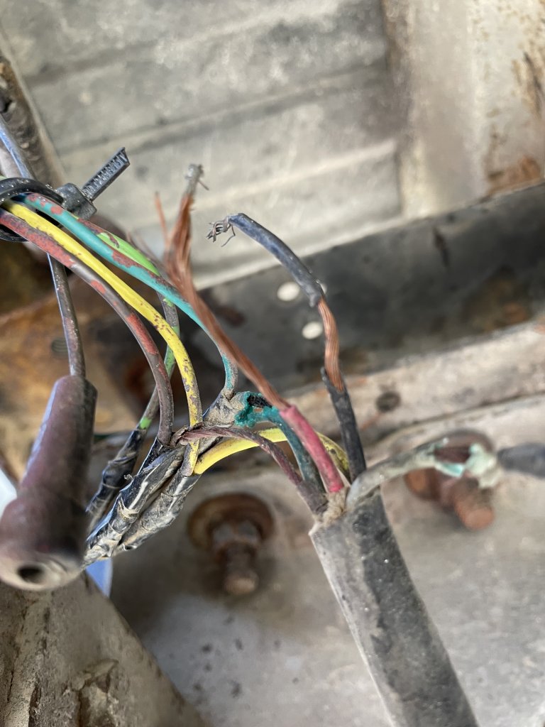

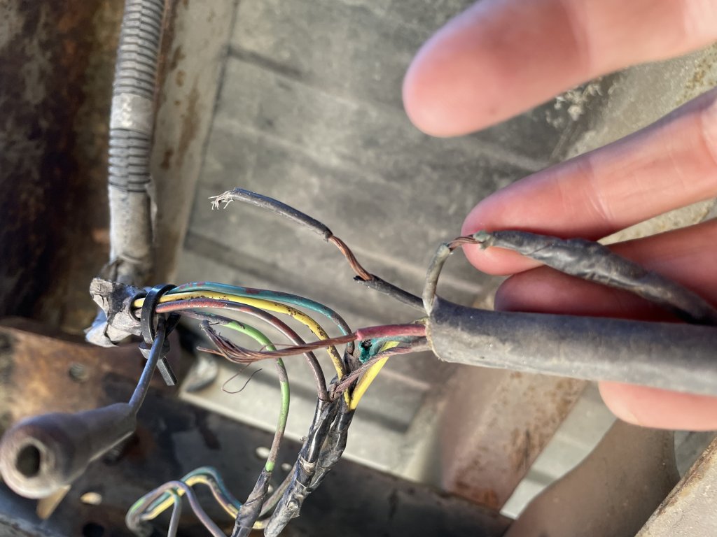

My 83, has wires first going to left tail light then going to the right tail light, in the middle PO spliced for trailer wiring; did terrible work which I am redoing with butt connectors, sealed. I think color wires follow standard diagrams.

Agree, it’s a head scratcher. I will be properly installing this soon, hopefully it’s a good product.
