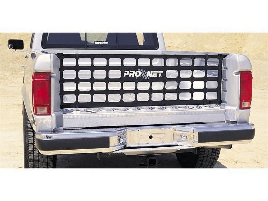

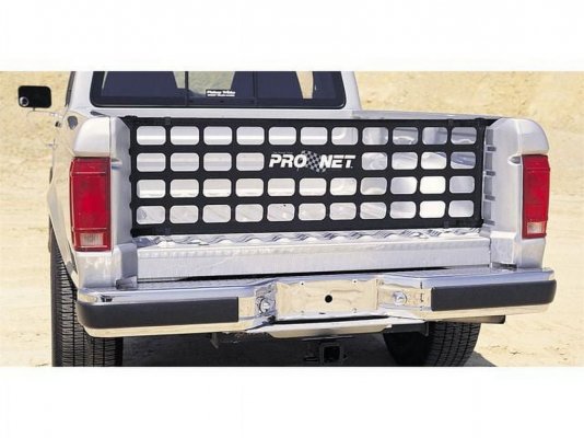

Good pics and description.
I always look for the cheapest, easiest solution:
