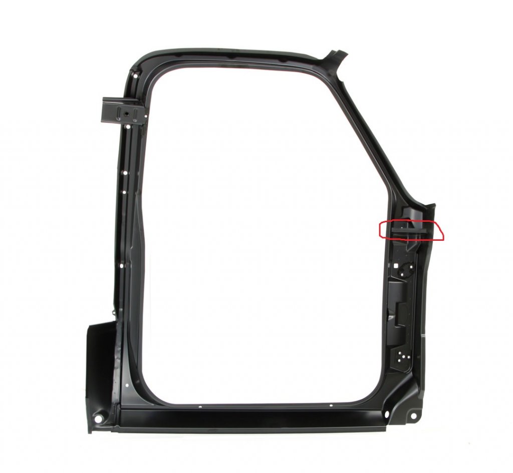

I'm in the process of repairing the door hinges and patching the bottom of the kick panel on the driver's side of my 75 GMC. The amount of heavy scale raining down from inside the pillar had me concerned, so I started looking around. There appears to be a baffle of some sort above the upper hinge mount, inside the pillar, that has rotted out. There is no rust on the exterior of the pillar, on the inside or outside, and I've already had the window out of this truck (Window frame was mint).
What is this baffle? Is it structural? How would you even access it without peeling apart the entire A-Pillar? The only thing I can find that shows it is this photo I'm attaching of an entire door surround frame patch panel, it appears to the the little baffle I've circled in red.

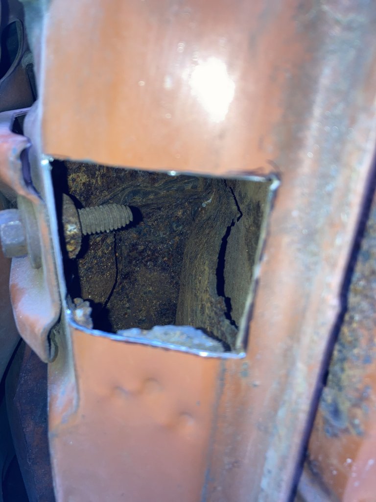

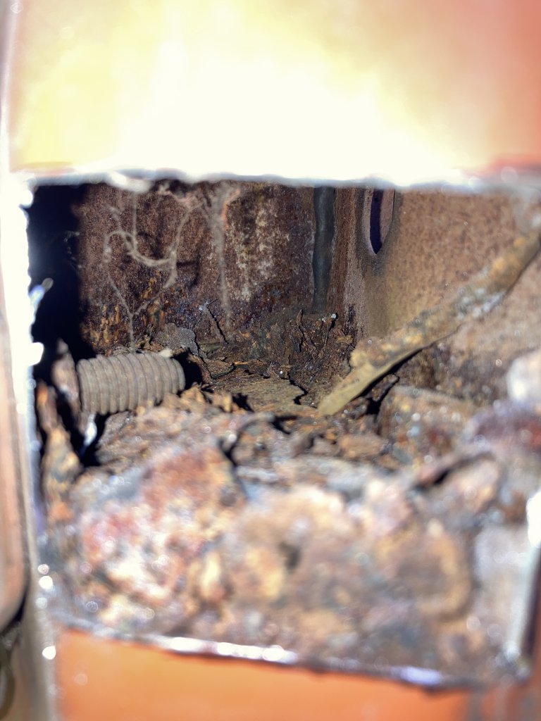

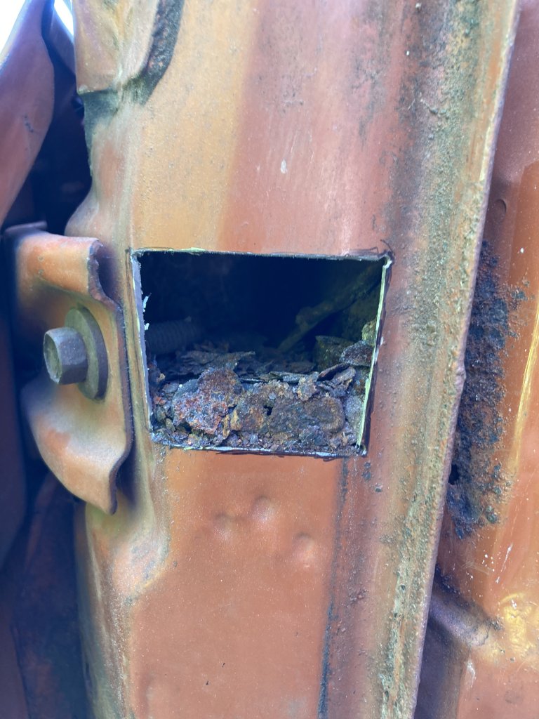

Followup - I cut an access window into the pillar, and was met with this mess - After vacuuming everything out, that internal panel is pretty much completely missing, and a little of the top of the upper kick panel as well. I see no way to repair/replace this without completely de-laminating all four layers of the pillar. No idea what caused this as there is no mouse nest or other buildup of any sort that would have rotted it out from the inside. I am tempting to clean everything up, paint it, ignore the missing metal, and weld the pillar back up. Any ideas/thoughts?

Well that's why you don't go pokin', lookin' for things you don't wanna see! Lol.
Honestly, I'd just clean it up, coat the inside and weld it back up. Then pretend you never saw what you saw.

No cab lights or anything else installed on the roof that would have led to this - only thing I could think of is a leaking drip rail screw? Looking closer at the structure, I think I can replace this area if I remove the front fender (which I need to do anyways), and cut a much larger access window in the outer pillar. I think I may need to do this because the outer pillar is really thin in that area where it was rotting from the inside out. I will post photos of the process if I choose to go that route, if anyone else ever encounters this. I've searched the forums and internet and haven't found anyone with a similar problem.
It is a silly design - the area was completely sealed with seam sealer as well from the inside where all the panels met. If any water, or even condensation, got in the roof and ran down the pillar, it would pool there with nowhere to go. If I recreate that piece I will at the very least leave a hole in the middle for water to drain out in the future.

Ditto. This is a common design flaw with lots of old cars. I had the same problem with my 64 Chevelle. The pillar filled up with crap over the years and rusted out the bottom hinge plates, but the top ones were perfect. I cut the pillar open where the fender would hide the patch, cleaned it all out, and treated the rust, made new stainless steel hinge mounting plates and used the hole I cut to fish them back in there, then put it all back together.

- yes it is structural
- yes there are at least 4 layers of steel structure to be removed to get to the problem area
- no its not worth doing as the door won't fall off and the truck wont fall apart if you don't "fix" it.
I think these trucks were heavily over designed, so the loss of part of a small bulkhead will probably not cause issues ( but i'm not a certified structural injuneer . so what do I know ? .. )
- prolly still have the hinge pillar lurking on a shelf somewhere if you need a pic of the inside ( may have tossed it )
- note the rust holes at the join of the firewall and outer/upper valance. This is why your carpets are always wet ...

I discovered the same cabinet while repairing my ’78, and yeah, it was in crumbs too. It's not really structural, more for local support/ reinforcement, so not critical but useful. Personally, I cut out a small access hatch in the A-pillar to access it without destroying everything.
