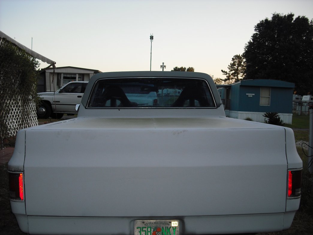

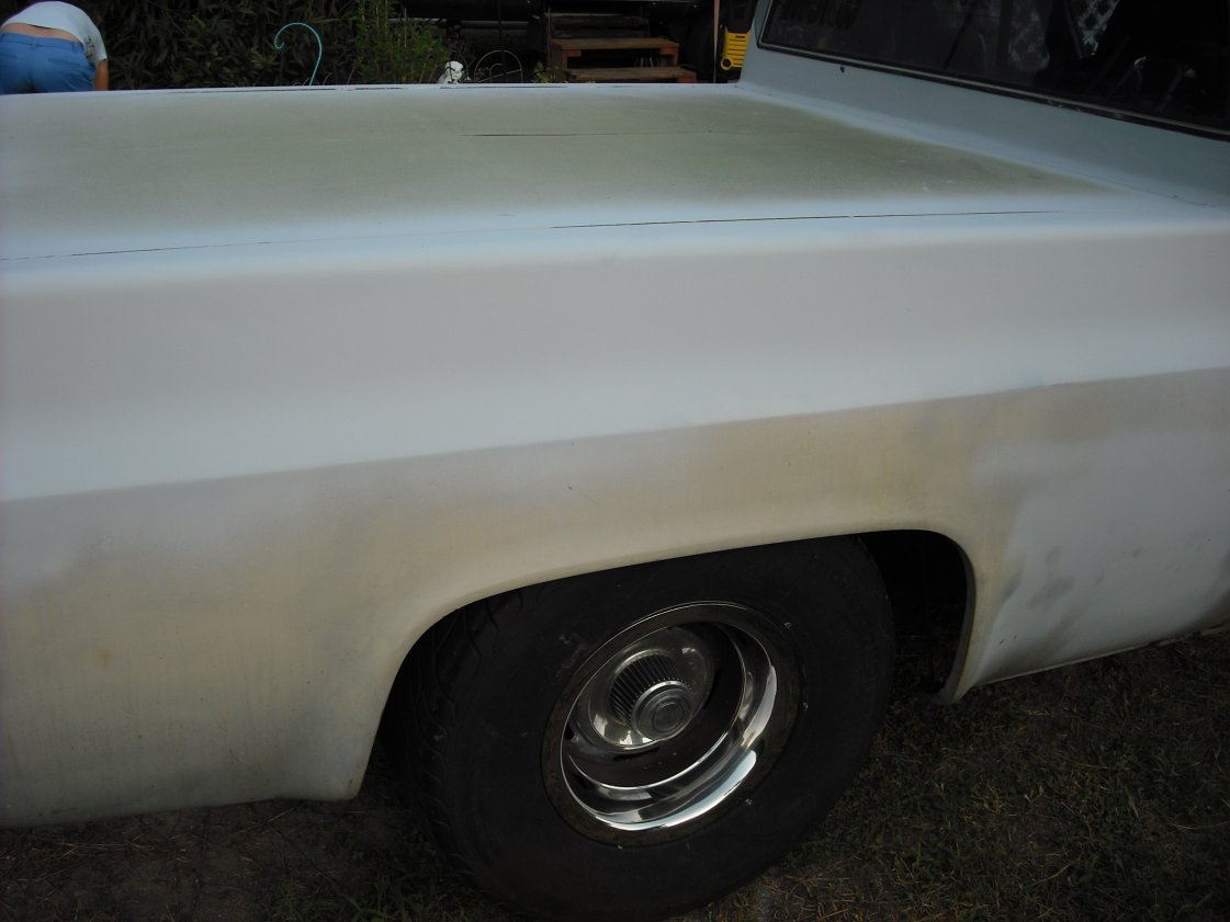

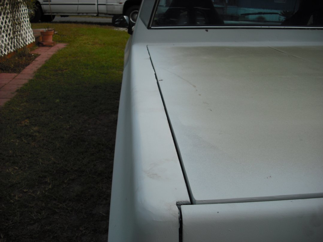

porn pic's bonded tail gate cover on (no welding no screws ) and bonded the 20 gauge sheet steel to the bed cover frame

Looks great! Love the clean look.
