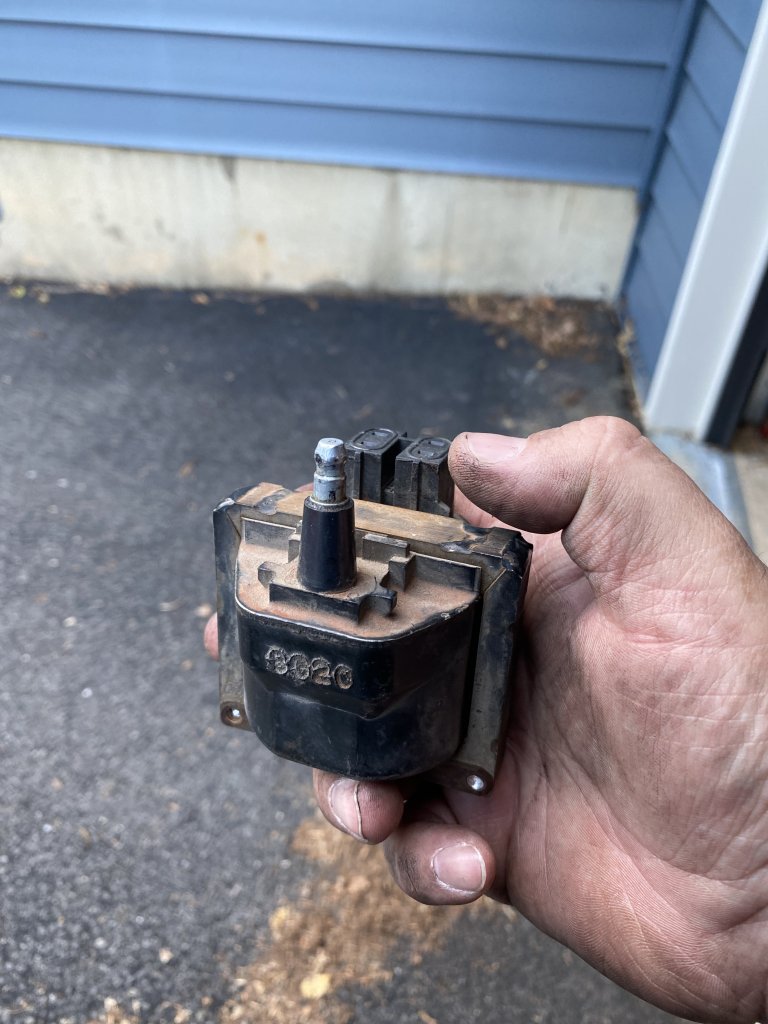

I had exactly the same experience. I rebuilt my dash with a tach upgrade from LMC, and the tach would bounce when driving, but not at idle.
The old tach looks like the original, with at least 200k and 33years on the clock.
New tach and it works great!
