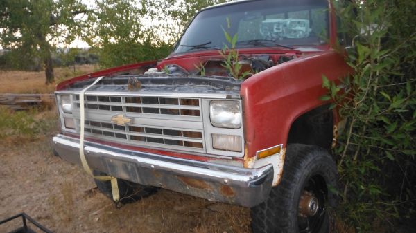

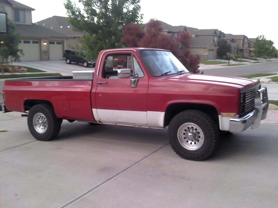

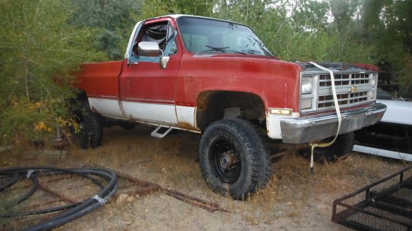

I am in the process of buying a 86 chevy k20 with a hydraulic clutch setup i was curious if that will be a problem when i drop my 83 C20 body onto the frame the 83 has the mechanical clutch but both trucks are running
the SM465 just one is 2WD and the other is 4WD The first and last picture is the body i want to put on the k20 frame the three pictures in the middle

It might be easier to swap bellhousings and clutches too, rather than swap pedal assemblies and drill/patch a bunch of holes in the firewall.

Is the goal to switch bodies and still have two running trucks? If so, keep the clutch setups with the matching bodies.
If you are just building one truck how you like it, use the clutch setup you prefer. I like the hydro setup myself. If you don't really care, go with the mechanical setup because the hydro stuff is worth more to resell.

Whatever you want to do isn't going to be a problem. It's just a matter of deciding which clutch system you'll want. Do you want to keep the mechanical Z bar linkage you have now, or do you want the hydraulic set up that's sin the K20? If you're using all your current stuff in your current truck, same linkage, same bellhousing and all, then no problem.
You biggest issue here will be, you'll need to cut out and swap the center transmission humps in the 2WD cab to accomodate a transfer case. So you'll cut the hump out of the 86 K20 and tack weld it in the C20 cab.
What you're actually doing here, is a 4x4 conversion vis Frame Swap which is the most sensible way of doing so.
