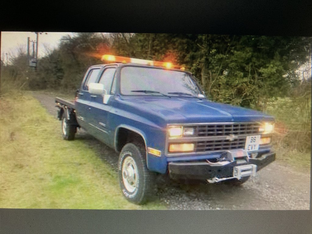

Nice truck sir. Looks great. I'm going to do the same with mine. The blue I'm going to use is Strata Blue, actual USAF blue, and the topper will be the same. I'm making a re creation of an old flightline vehicle, complete with a lightbar with amber lenses, and serial number on the doors. Serial number will of course be the year of my truck(84) then the month and year I went in to basic.
