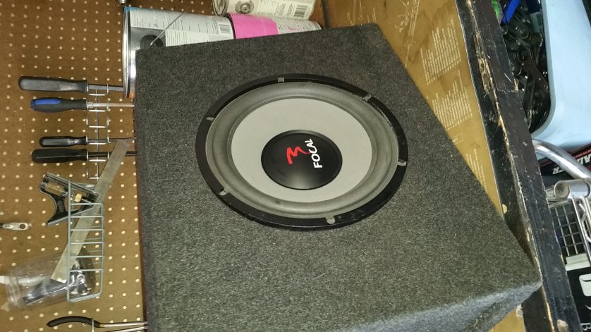

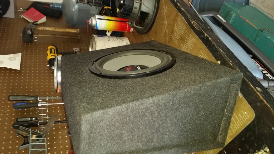

NOPHO84K30
Feb 28, 2013
482
103
north phoenix
justin
1984 silverado k30
K30 dana 60 corp14 ff
454 sm465 np205
This is what i have in mine its a focal 10. I thought the magnet on it was big but yours gots it beat.
