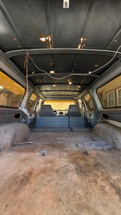

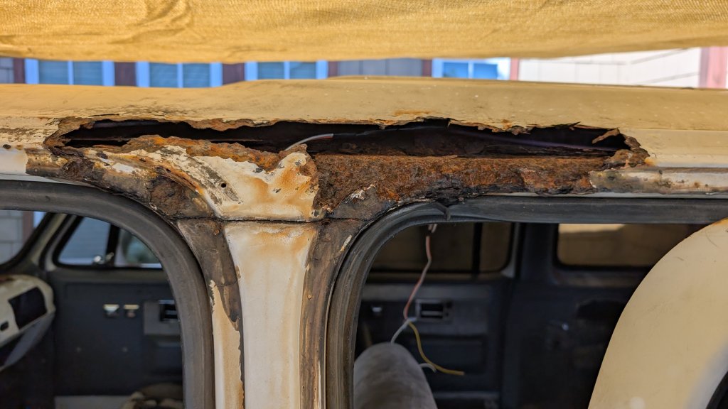

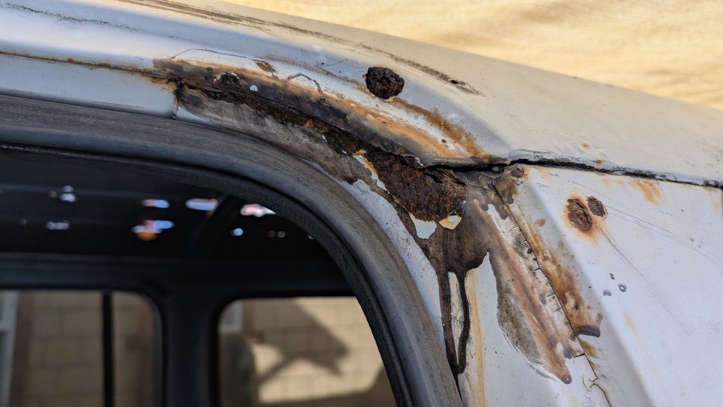

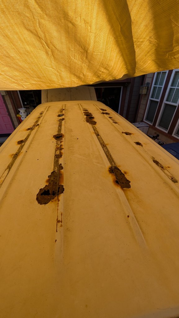

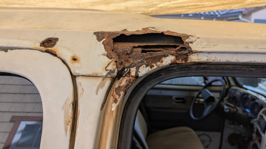

@w-cummins how did this replacement go? I have a roof in much worse condition than yours. My '88 V10 factory roof rack studs all rusted out on me, plus I have the same front/rear door jam rot. I have a '83 2500 donor. Just trying to plan my attack.
Holy swiss cheese Batman!!!
