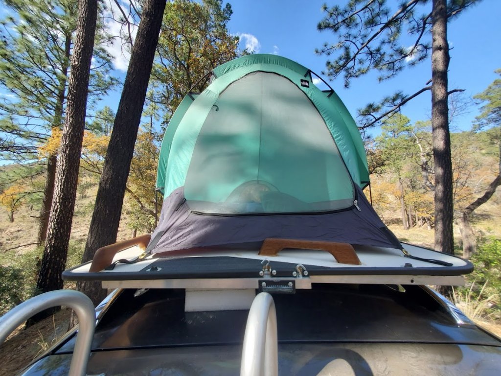

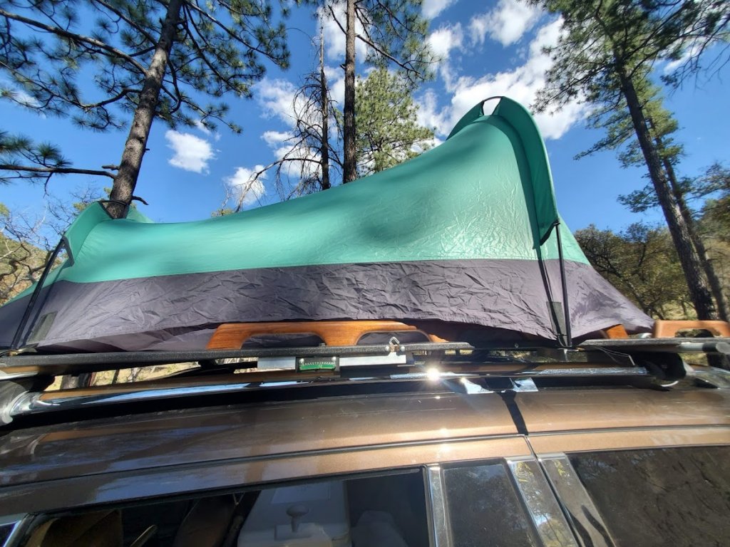

I think if you reinforced all the mounting points with stainless bolts to the interior of the roof you would be fine. Rubber grommets on the outside and large fender washers on the inside. Not the most elegant of solutions but it should be extremely strong.
I think ALL of the aftermarket roof tents are insanely priced. I made my own platform for my Mercedes SUV with plywood, ski rack clamps and a standard North Face 2 person tent. It takes about 10 minutes to set it up securely and less than 5 to take it down.
