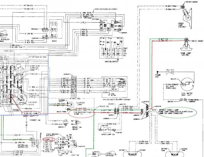

Do you have a cargo lamp for the bed of the truck or not? That would change how it is wired in the truck.
If you do then the cargo and dome lamp connect together behind the rear speaker on the driver side.
If not then dome lamp feeds into the door jamb harness to the driver door.
I used green for the "ground" and red for the "hot" side.
Last but not least, you are using a TWO post bulb in the dome lamp and a one post lamp in the courtesy light below the dash. If you use a one post bulb in dome lamp it will blow the T/L CTSY fuse every time.

Well balls thats my problem. One post bulb. Oh yeah saw that one here last night. Oh my head is spinning with this truck but I think it's settling down now... I hope lol.

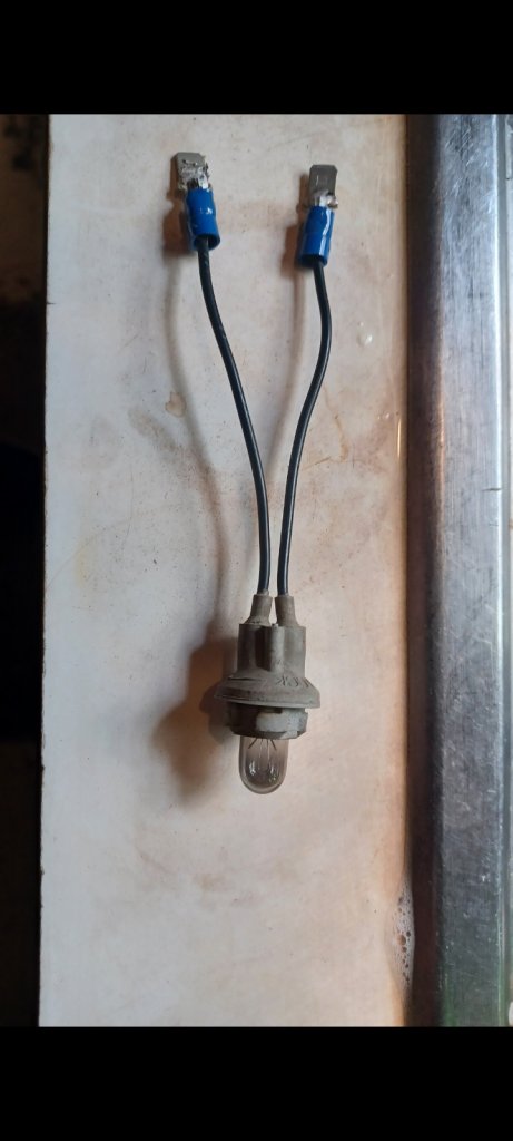

Drove myself crazy trying to track down a short blowing fuse after fuse while rewiring my dome light that appears to have been inoperable for years. Triple checked the wiring but kept blowing fuses when I tried to turn it on.
Searched the forum and found this post, then checked my light bulb - one post! Problem solved, and I’ve got a dome light now.

Make yourself one of these for chasing electrical shorts. Replace your fuse with this if the bulb lights you have a short and would blow a fuse. When your light will no longer light insert the fuse. 1 bulb vs 1000 fuses. The fuse box is hot the bulb becomes your load the short is the ground that lights the bulb or blows a fuse. Depending on whether you use a bulb or a fuse.
