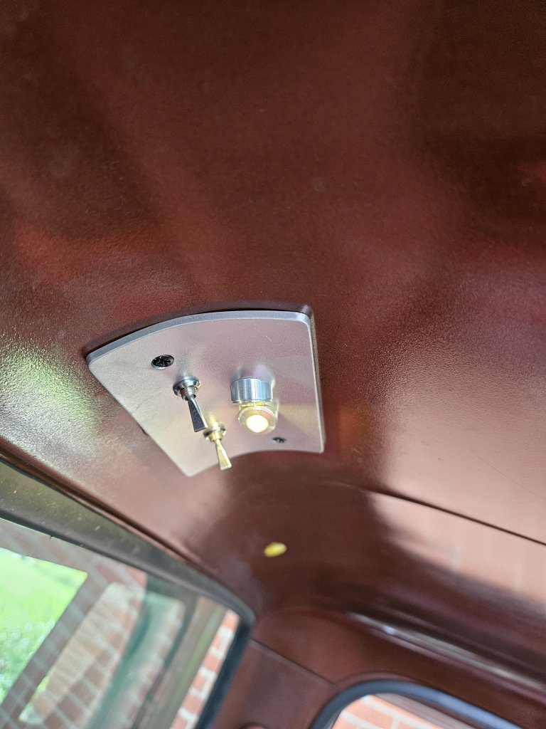

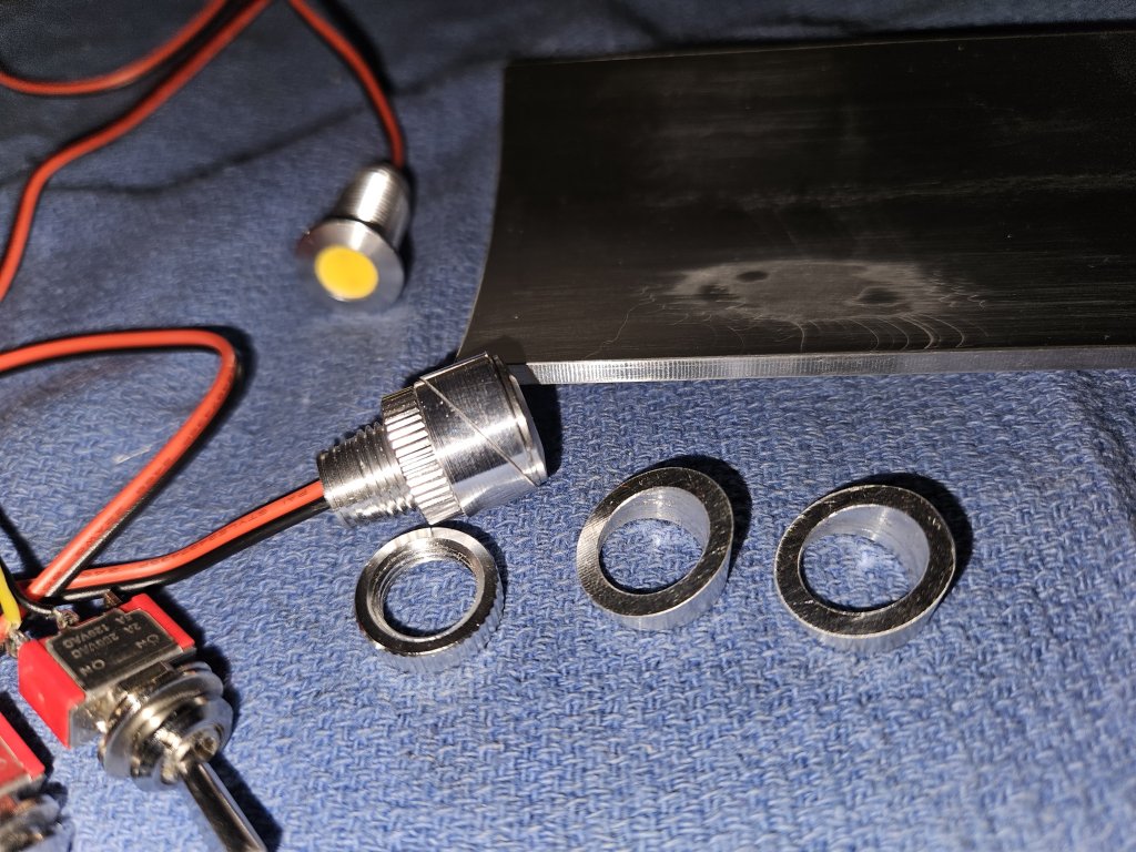

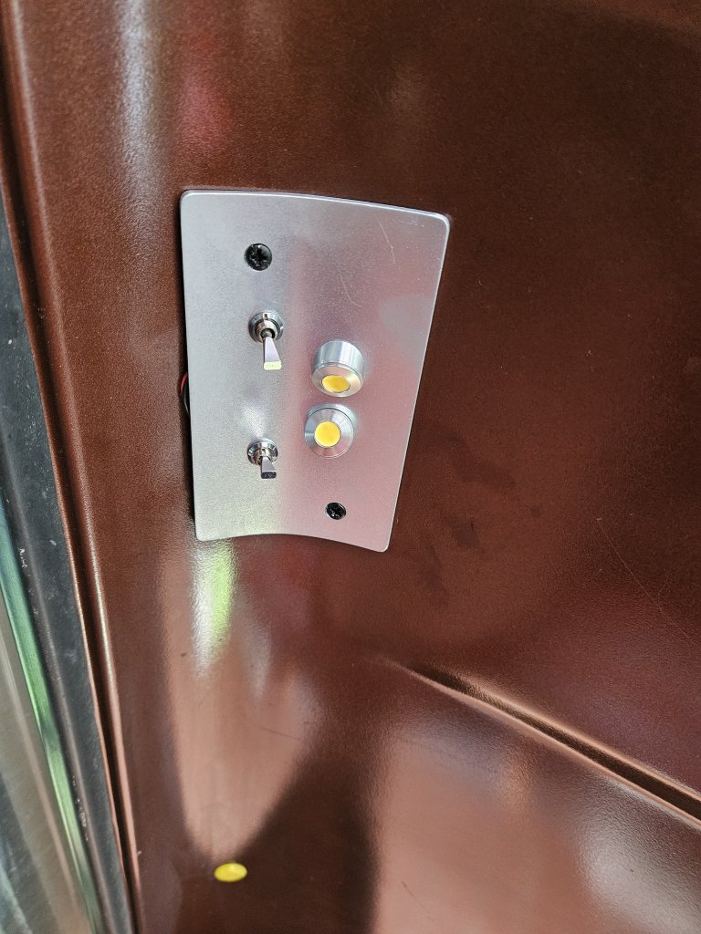

There have been times, while driving at night, when she needed the dome light on as.
And it was either in my old 73 Audi or one of our Accords, that we had a dome light on each side. One for driver and one for passenger. I think there was one for the backsest as well.
That brings us back to a single dome light in the truck and it is lacking in effectiveness.
Honestly, if she needs a decent light, the camera that seconds as a phone works better.
Well, I wanted a better light and I had been kicking around ideas on what I wanted. LEDs for sure but it's hard to find ones thst are not annoying in color and their "buzz". Yes, I can see that annoying buzz that LEDs do.
I found a company that makes LEDs for automotive and marine applications and I have ordered from them before. Service is great and quality is top notch.

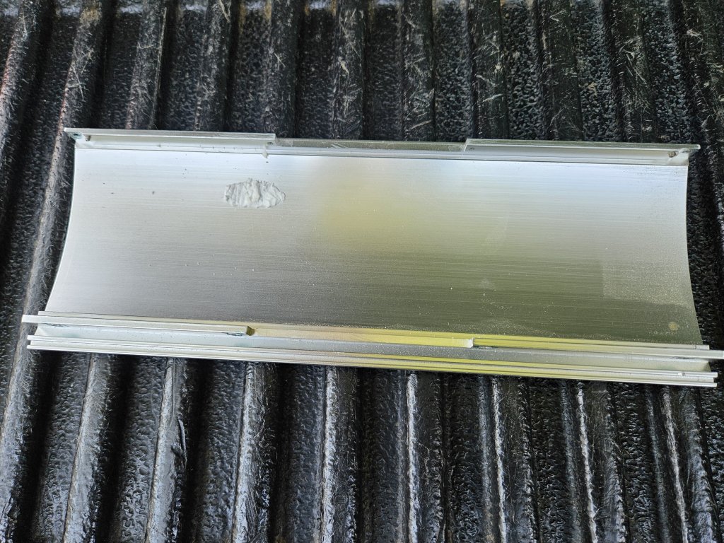

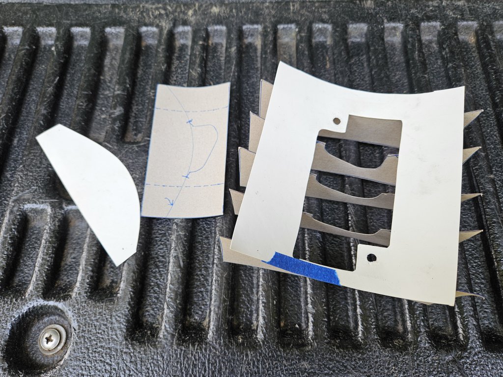

So I cut some cardboard templets and sketched out a few ideas. And then set the whole thing aside for a few weeks. Other things just got in the way. In cleaning out some junk, I came across an old housing that was the base for a 3D scanner. The university had it and they were tossing it out. I wanted to get it working, the manufacturer wanted to justsell me a new one. Out came the screwdriver and the dismantling proceeded.
Anywho, the box that housed the electronics was made of fancy aluminum extrusions. Sometimes it's hard to throw away perfectly good junk. Ya know?...
Well, this one extruded piece look real close to the curve the dome light sets in and looks like a really good start.
Lay out some lines and grab the saw. Square up the edges and check the curve. It needs a touch more curve put into it and a couple minutes at the press makes it almost perfect.

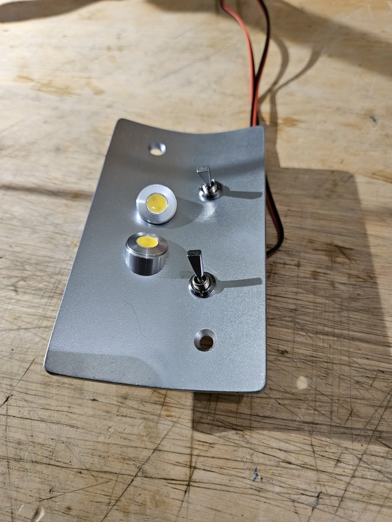

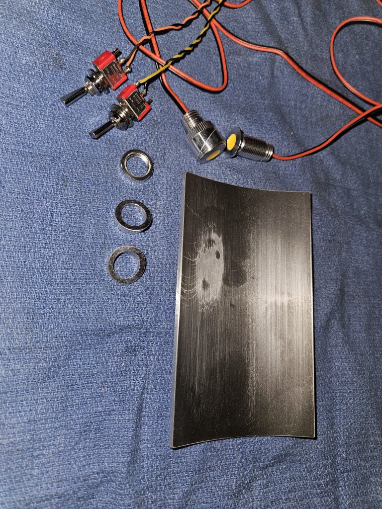

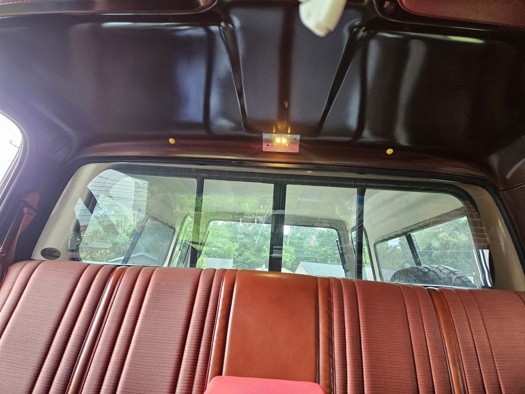

I wanted this light to be pointing toward driver and passenger side and either one can be turned on or off by a switch dedicated to the light for that side. I had determined the angle for each side and made a set of angular bushings for each light. Drilled a few holes for the lights, switches and mounting screws (original).
Assembled everything and wired it up. Plugged it in and it works as it should. Hot dog!

My solution was to install a rearview mirror from a 2001 Silverado. It has built in lights that are adjustable, thermometer, compass and best of all, it's self dimming.
And for the rear, Sylvania makes an led that's pure white (5k) and sold in AutoZone. Been flawless for many years now.
I do applaud your ingenuity and craftsmanship.

I did what @SquareRoot did, lighted rearview mirror. No other extras, just the lights. On with the dome or each side with individual switches. Shotgun rider needs to see to roll....
